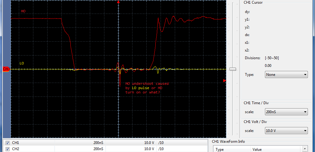

What can be done to calm 10Mhz ringing of HO output causing random very high VDS peaks? Is there some way to reduce HO output bias slowing the rise time other than adding excessive amounts of gate drive resistance or adding gate capacitance? It seems the flat top is more indicating of IAS events than we currently are seeing.
Adding gate capacitance seems counter intuitive to what TI documents are claiming about LS/LD/Q. Can the typical HO gate drive pull down resistor value connected to HS effect the HO output signal if it is to large in value? Why is there no mention of TI gate drivers HO output causing turn on oscillations when NFETS are being used versus IGBT modules? The problem is the source side voltage peak shown in captures can exceed VBR(DSS) at higher working voltages if left unchecked.
These voltage spikes seem much worse with the faster UCC and how much gate resistance is considered to much for small QG-NC values? Can COM pin tied to ground plane lead to high VDS spikes when digital ground is isolated from analog ground or COM? Note the HO output capture above is not consider avalanche being the top is not flat as shown below but it easily could enter IAS with higher working voltages exceeding VBR(DSS).

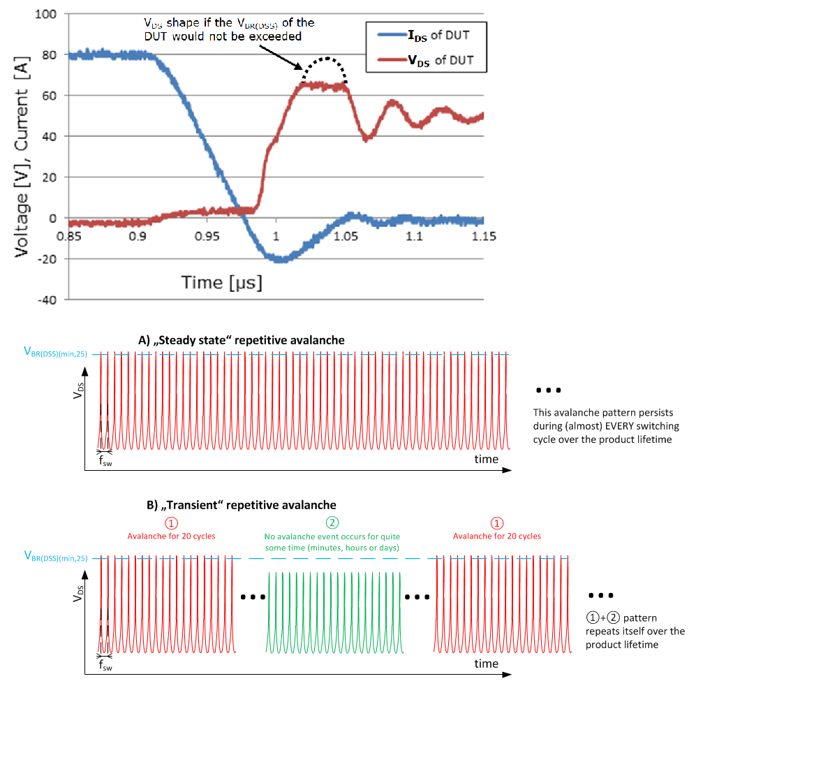

    BVDSS=200V and when Bus voltage finally +165v easily be pushing IAS single pulse envelope! Sadly the next step up 80vdc is behaving badly in light of random source spikes.

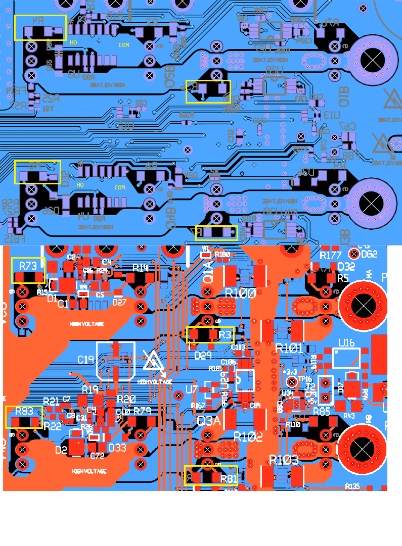

    Perhaps a good thing Rgate is placed right next to the gate lead. The HO leads were kept very short in the parallel FET layout. Oddly HO oscillating (9-13.5Mhz) is far worse than LO which has much longer traces.

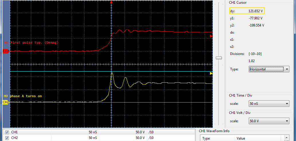

    Our DC supply now 80vdc, HO driven NFET source pulse peaks reach 122v, very periodic / typical. In my opinion the rise time after Miller plateau is way to fast for NFETS with low QG-NC, perhaps below 100NC. The datasheet title seems to misrepresent UCC being good for NFET's, 4amp gate drive / motor drive, together they seem to be a bad combination when producing trapezoidal wave forms. There are no transients being produced by our PCB layout causing the UCC gate driver HO/HS to misbehave. On the other hand the UCC is procuring high voltage DC transients by it's HO/HS structures when producing trapezoidal wave forms.

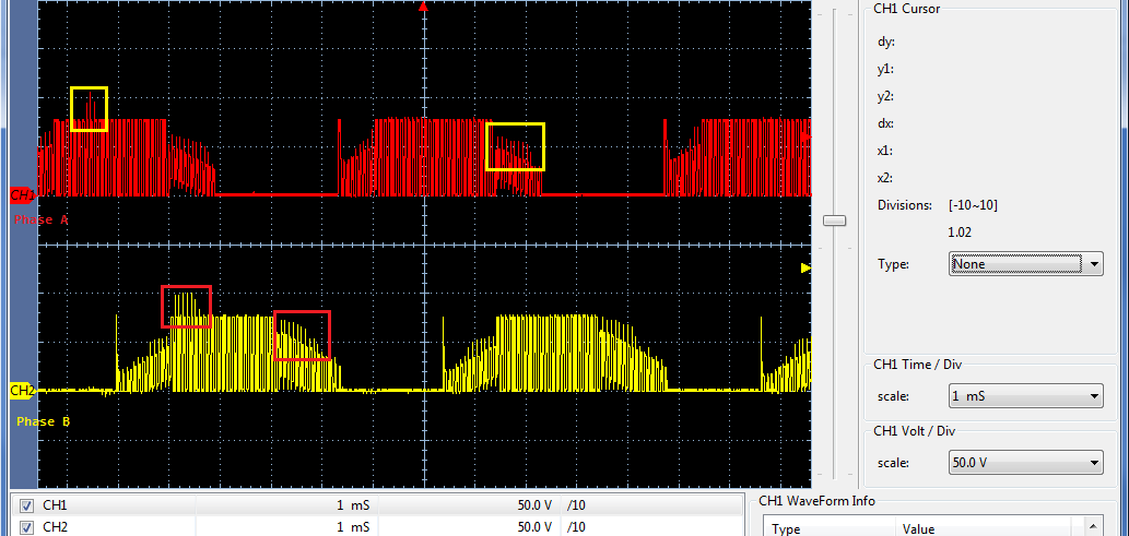

    These updated captures (80VDS) 12.5Khz shows rise time and magnitude of typical aggravate pulses being produced via trapezoidal wave form.  We use center aligned overlapping HI/LI inputs from three PWM generators  (TM4C1294KCPDT) to drive local 3 phase inverter as explained above post. Notice the only pulse that is never above VDSS is the very first pulse at the beginning of each trapezoidal wave form, code step 1-2. Reducing slew rate on HI input relative to LO slew rate makes no difference to the magnitude of pulses. It appears the UCC 1/2 bridges are attempting to boost the motors stator voltage as if it were a power supply. These HO drive high voltage peaks were not present in our PCB prototype using a much slower gate driver.
    Has TI produced another gate driver with same pin out that may correct this condition? Increasing HO drive resistance beyond 75 ohms seems an odd way to correct what seems to be trigger pulse errata that occurs when the PWM duty cycle on LI overlaps HI in the same 1/2 bridge, even with high dead band times and 1.6us minimum pulse widths.

  • Perhaps TI could get TIDA-00778 engineer to write code to produce trapezoidal wave forms via UCC27714, the IGBT module (QG=275nc). Hard to imagine IGBT module would not produce similar results as above capture or worse being a saturated transistor back half.
    Center aligned HI/LI overlapping PWM duty cycle seems suspect leading to high random peaks in HO drive current, hence uncontrolled ringing/ripple current signature results HO output. Perhaps excessive holes flowing out/into the NFET gate region occur from excessive HO current gain. That would explain the uncontrolled random high voltage peaks produced via the NFET source and why larger gate resistor values on HO appear to slow down hole flow before single pulse IAS events occur. Obviously that latter method is not the WA we seek. If the UCC27714 has an errata condition, it would behoove all if made public in a disclosure PDF!

    Perhaps we can put a band aid on it or at least understand why the series Gate resistance has to be made very large for Trapezoidal wave forms? Adding 10k across HS/HO versus 20k did help reduce the peak somewhat at 80 VDSS. The total QGNC will double for parallel NFETS. The primary goal was to prove the PCB was functional as an inverter motor driver before blowing the crap out of very expensive NFETS in the process. So far we have destroyed 5 UCC in the process but can not understand how the HO output was compromised with the very same pulse widths we are using now. Oddly HO is not shorted to HS or HB or HS to COM/VDD pins.
    Derek Payne said:
    There are some isolated drivers, notably the 16-pin UCC21220, which could be adapted for similar functionality.
    Ok and do now see secondary pulses (typical) perhaps HI Schmidt pulse shaper becomes slightly saturated making Totem poles drive current accelerate HO gate drive. That is why 16.0v zener across HO/HS near each NFET has no ability to control current each inductive ringing cycle that occurs after. The demagnetization primary pulse is the only high pulse that stays even to 80 VDSS which occurs after HI has not been fired by 120 electrical degrees.
    Below is capture of the Trr recovery occurring along HS or ground. The center pulse caused by duty cycle @24 VDSS dead band time. Now at 80 VDSS had to make dead band 120ns and 1.6-1.8us minimum pulse width to stop over current fault conditions but that center pulse is not occurring at faster duty cycles. Basically HO turn off Trr is very clean (heal), hardly produces any (di/dv/dt), such makes the UCC superior in that regard.
  • Little dity below technical note: Shorter dead time effecting Qrr/Trr recovery was spot on and 80ns dead time removed di/dt negative undershoot pulses of Qrr.
    - Body diode conduction usually happens during dead time; therefore, it can be reduced by minimizing the dead time. However, there is always a limit how low the dead time could go down to.
    - Diode conduction current is often set by the chosen topology, and changing topology is normally not desired.
    Current slope (di/dt) is related to the parasitic inductance of the commutation loop. First, it would require a redesign of the PCB to improve Qrr. Second, a low di/dt means large parasitic inductance, which usually contradicts to a good PCB layout for high frequency application.
    Our PCB UCC footprint has virtually NO Qrr/Trr undershoot with the improved OPTIMOS-FD devices. 40% reduction in Qrr has significant efficiency benefits! Sadly improved Qrr can not slow down inductive inrush current shown in Trapezoidal waveforms VDS peaks that HO drive slew rate appears to aggravate.
