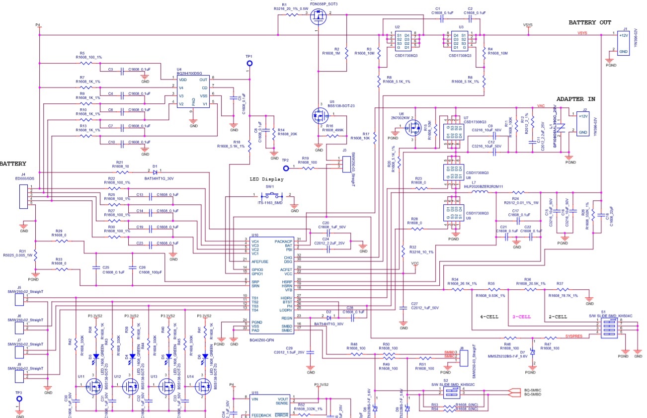

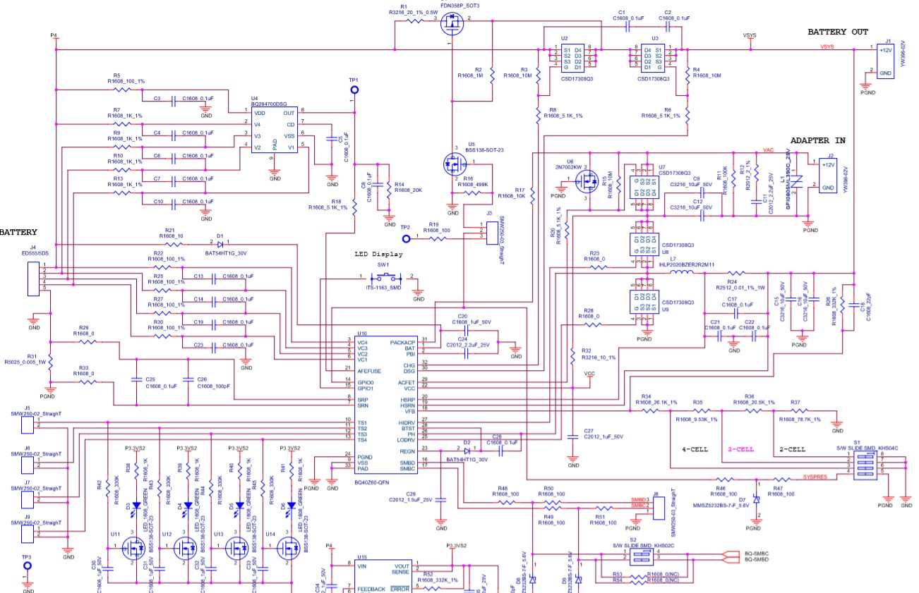

I have written and tested the same circuit as the BQ40Z60EVM.

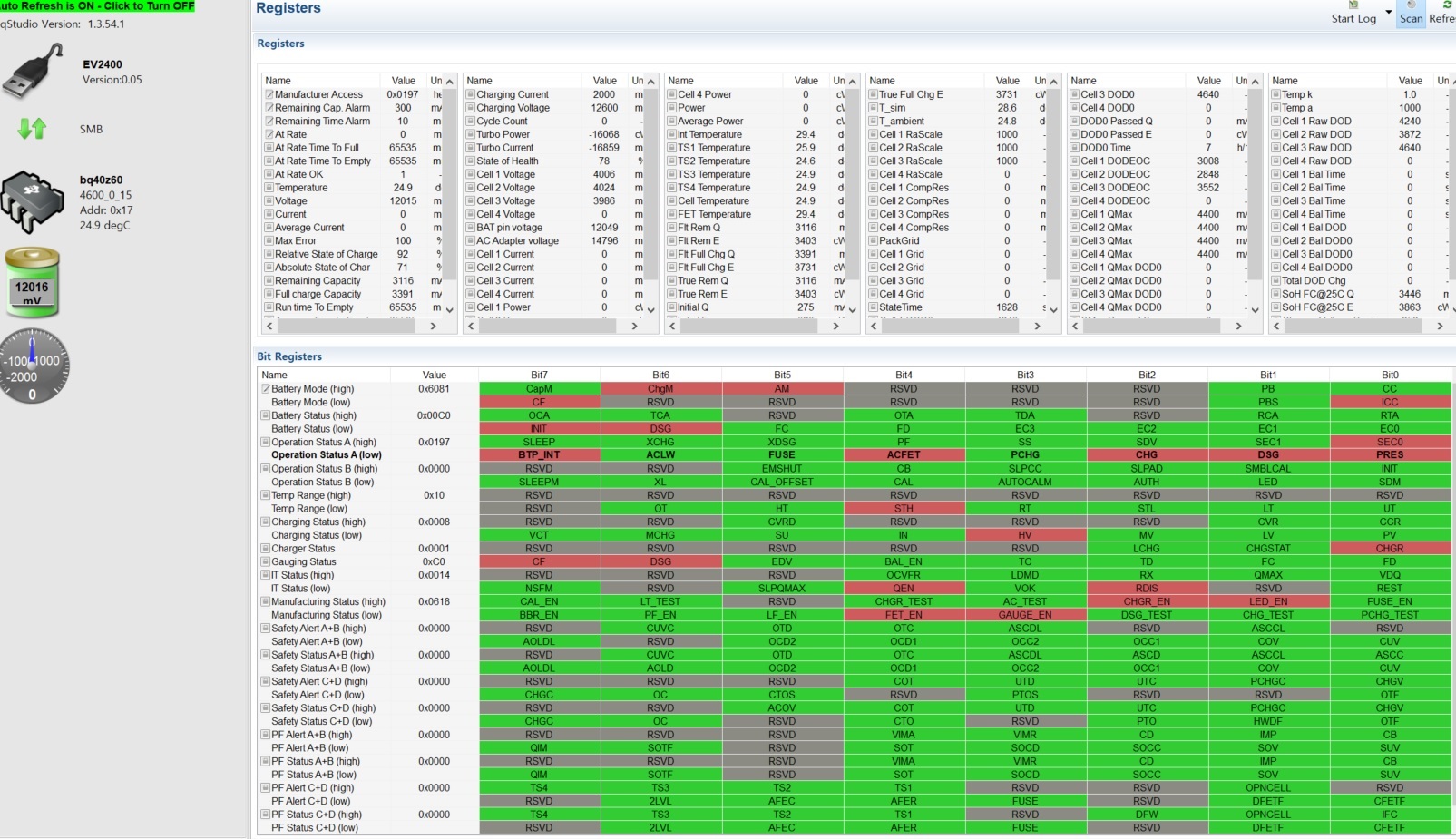

The battery to charge is 11.1v 3cell li-po. I'm observing the register through bqstudio, the CHGSTAT register is not set, and no charge current flows at all.

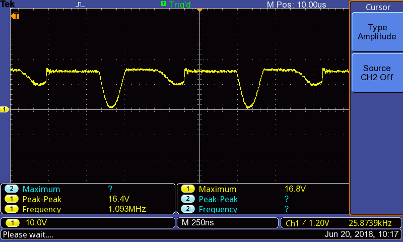

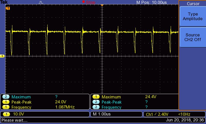

PH is not switched like an EVM as a result of taking an oscilloscope.
I would be grateful if someone could tell me which is the problem.
