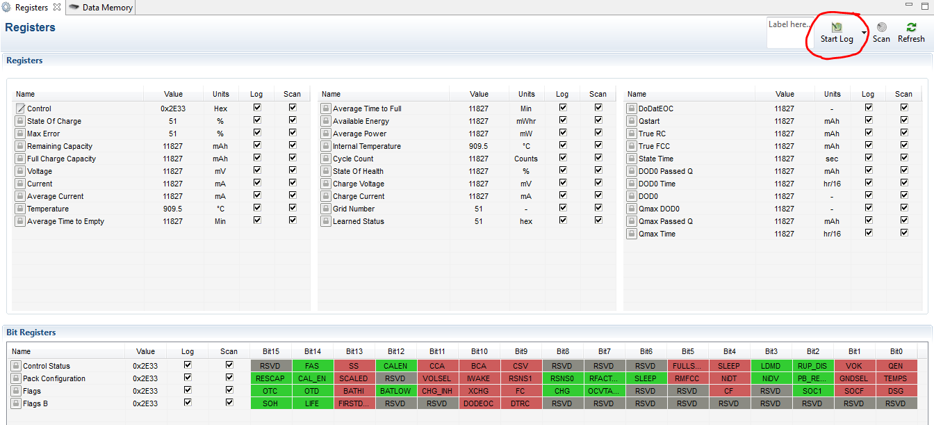

  • Hi SG,
    Can you please post a bqStudio log, when you are trying to charge.
    Do you see the "Operation Status A" [CHG] and DSG] bits (bit 2 and bit1) set (default color RED)?
    Swami
  • Hi Swami,
    The "Operation Status A" [CHG] and DSG] bits (bit 2 and bit1) display color GREEN as attached bit register.
    regards,
    SG.

  • Hi SG,
    The screen shots of bqStudio provides very limited information.
    Please post a log from bqStudio as well as your gg file so that we can check further.
    Swami

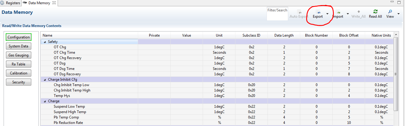

    The issue here is that in the Data Memory setting "Temperature Enable" and "Temperature Mode" [TS1] and [TS2] are enabled to measure FET temperature, but there is nothing assigned to measure the Cell temperature.
    So the cell temperature is being measured as -273.2degC, causing an under temperature condition that will prevent charge or discharge.
    Also, normally when posting a gg file, we recommend that you don't save it using excel since some of the bit fields get lost in the process. It is much easier for us to analyze if the .gg.csv format is maintained.
    Swami

  • Hi SG,
    From the gg and log file I see that the learning cycle was successful since "Gas Gauging","State","Update Status","0e","-" means Qmax and Ra tables were updated, and in the log file the Max Error is 1%.
    The only issue with the settings in the gg file is that tehe "Gas Gauging","IT Cfg","Term Voltage","9000","mV" seems too low for a 4S configuration. typically for 4S with minimum cell voltage of 3000mV, this value will be 12000mV.
    I don't see any protections being triggered in the log file and it looks like both CHG and DSG Fets are on, so there should be nothing preventing you from charging or discharging.
    To make sure, I would recommend measuring the Vgs on the CHG and DSG Fet to make sure they are turned on.
    Swami
  • Hi Swami
    Thanks for your response.
    1.in additional in "data memory" setting  any setting parameter change is required?
    2.  full discharge status when connected the battery charger the charge is toggling what could be the reason, how to resolve?
    regards,
    sg.
  • Hi SG,
    1. Apart from the "Term Voltage", I did not see anything obvious. Many of the parameters will depend on your specific application.
    2. To clarify, is the CHG Fet toggling on and off? Can you post a scope capture of the DSG Fet gate if this is the case.
    Swami
