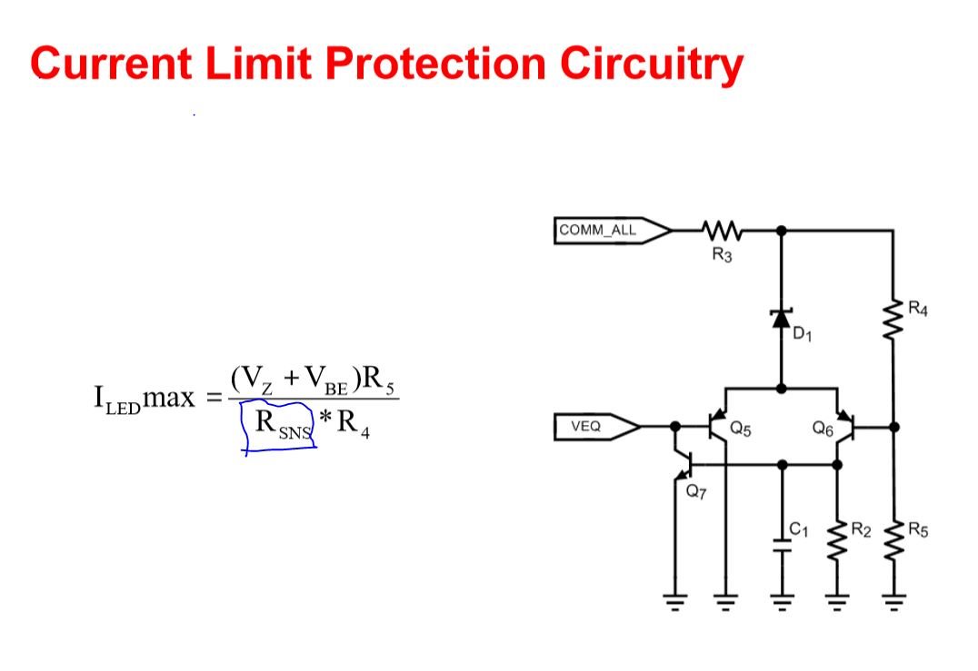

1. Is there a formula to obtain R11 / R21 / R31/ R41 resistance in schematic?
   -. I can not find it on DASHEET.
2. Does the LED Stning have a constant current even if the voltage is different?
3. What is Rsns in the formula below?
 -. source:
  http://www.ti.com/lit/ug/snou032/snou032.pdf
    1) It is in the datasheet though you have a choice in how to calculated it. Below is an example where Vsen is chosen at 0.35V. If setting the LED current to 350 mA per string Rsen would be 1 ohm. So if there was a current source of 1400 mA and four equal channels of LM3466 string would have 350 mA, Vsen would be 350 mV.

    2) Yes, the intent of the LM3466 is to share current even when the LED string voltages do not match.
    3) Rsns is what you calculated for your design per #1 above, it is Rsen. Example, if you have a 1 amp current source and two channels of LEDs sharing equally they will each have 500 mA. If you pick Vsen of 300 mV Rsen becomes 300 mV/500 mA = 0.6 ohms. If you chose Vsen of 200 mV Rsen becomes 200 mV/500 mA = 0.4 ohms.
    The current limit protection circuit above will be very inaccurate with regards to temperature due to relying on Vbe. If you chose a low Vsen voltage it will become more inaccurate. In your design do you need this added protection? Or are you just looking for current sharing between multiple strings.
