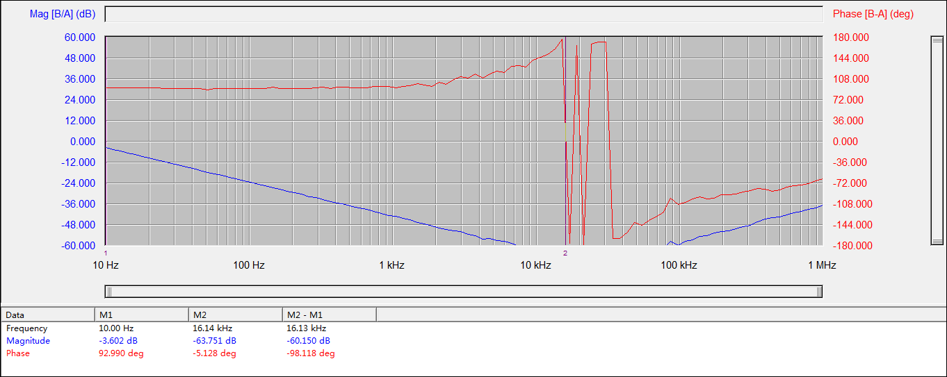

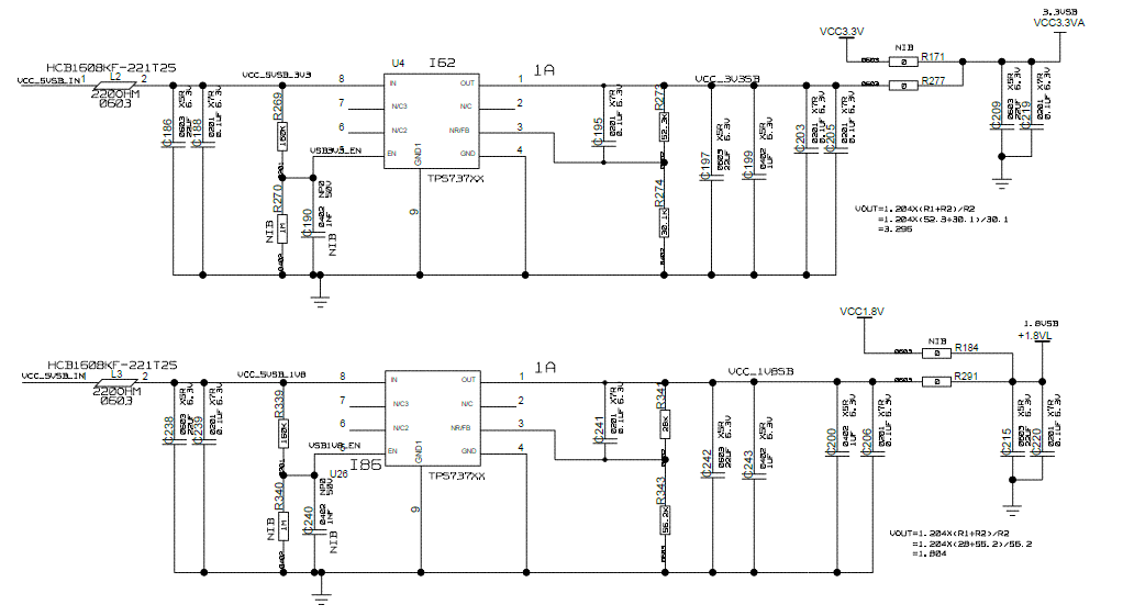

below is the shcematic and bode figure, customer want to konw why the crossover frequency in bode figure of TPS73701 is too low?
could you help to check bode figure on EVM?
thanks
