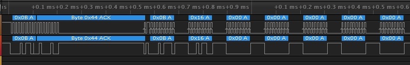

Having some problems with a basic read of the device ID.

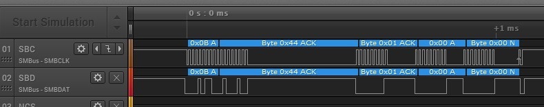

I issue a SMBus write to 0x44 with the data 0x01,0x00 (Register 0x0001) (and optionally a zero PEC byte) per the diagram below.
I wait 22ms and then issue another write to 0x44, followed by a repeated start.  I do not get any meaningful data back, instead I almost always get 0x16 as the first byte back after the repeated start, per the diagram below. The data is always meaningless in that it has a 0x16, and always zero afterwards.
Can anyone see what I'm doing wrong?.  Please note I have tried not sending a 0x00 PEC byte, with the same results.

  • Hi, thanks for the question. It seems you are doing the first part right, where you write to 0x44 with the register you will read (01 00) in this case since it is little endian. However, in the second part, you need to read 0x44 (you state you write it again in your message). When you read 0x44, you should get the data you are looking for.

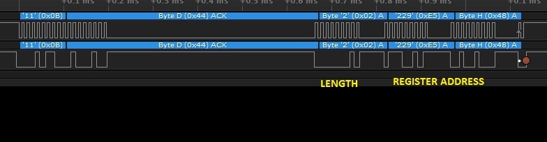

    Write to slave 0x16, manufacturer access command 0x44, to address 0x48E5:

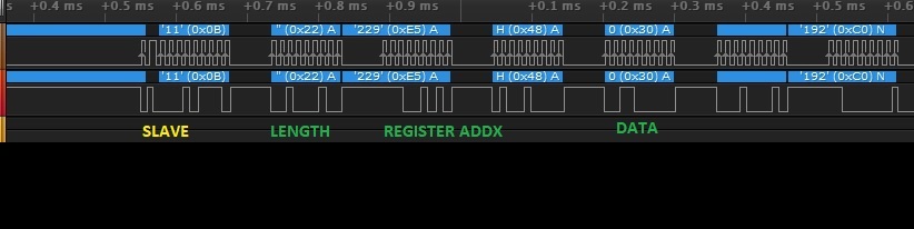

    And read back from 0x44 at slave address 0x16 returns the length, register address and the data.
