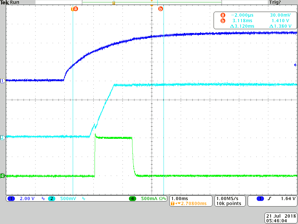

    I have tested this in the lab on an EVM, and I can re-produce results that are very similar to the customer's scope shot.
    The load of 1.05A is applied immediately as the voltage begins to ramp. The voltage rises consistently from 0 to 100% of the desired output within the expected "soft start time of 750us, and the voltage never collapses because the max current is never exceeded.
    My conclusion is that this behavior is expected and will not cause any issues
    Ch1 = VIN, Ch2 = VDCDC1, Ch4 = IDCDC1 (Load current)
    If the customer does not want to see this pulse of current, they need to manually delay the IC which is applying the load on the DC-DC converter. Most ICs have an Enable pin that will prevent them from applying the full load until the output voltage has increased above a certain threshold. Each DC-DC converter has a Power Good bit in the Register Map which can be read by I2C. When DCDC1's Power Good bit = 1, then the full load can be turned on.
