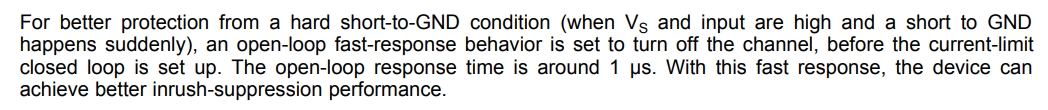

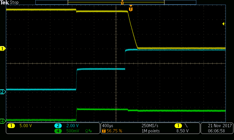

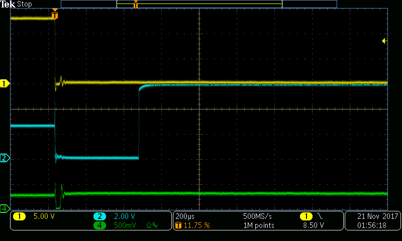

  •   Your understanding is correct. The device regulates the current limit at the set value and the FET is in saturation region. The OUTPUT still delivering the regulated current as long as the junction temperature is below Tsd. Reaching the Tds depends on supply voltage, current limit set and ambient temperature.
    The FET turns off momentary in case of hard short to GND due to fast loop of 1uS response time. After the momentary turn off the FET comes back on automatically and regulates the current at the current limit set. Attached pictures shows the behavior in case of over load and hard short.
    Scope channels CH1 = VOUT, CH2 = CS signal and CH4 = laod current

    Q1: Regarding the waveform you posted above;
    The left side waveform is in case of "hard short" ? And The right side waveform is in case of "over load"?
    If it so,(at the right side waveform) Vout was turned off because of thermal shutdown? It looks the Vout turnd off because of the current limit.

    The time delay for the output switching low, in over current, depends on the overload. If the load current is higher than 1.5 x current limit set, the output is low immediately. The FET gate drive turns off momentary in 3 conditions:
    1. Out short to GND
    2. TSD triggered
    3. TSW triggered
    Please check attached bench test measurements and description for overload behavior.
    1uS is typical value. Is that correct?
    How much is the variation of the response time (1uS)?
    Koji Hamamoto
  • Hi Koji-san,
    yes the 1uS is typical value. There is no specification for the response time.
