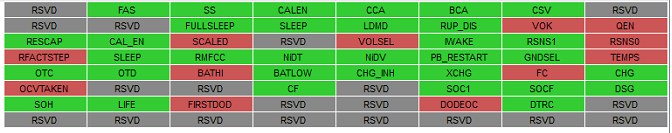

  • Interesting.
    The Update Status now has become 0x05, and Max error is at 3%. I just finished charging for the second time (charge - relax - discharge - relax - CHARGE - relax - discharge). The interesting part is that OCVtaken did clear after charging but VOK stayed set. I let it rest for about 3 hours and now that OCVtaken has set, yet VOK is still set. Basically both are set to 1. Is this to be expected? I thought once OCVtaken gets set VOK should clear, but this time it did not...
    I did just finish charging 3 hours ago, I will let it rest for 24 hours more. Any thoughts Mr. Kahler?
    Attached is the screenshot of the registers from BQstudio for clarity. Again, from what I understand VOK should be cleared by now. Thanks!
  • Hi Ramon,
    Yes, please let it relax.
    If it still has not updated to 0x06, please review the log to see if there were any current spikes, noise, and/or jumps in the log that would cause Ra not to update.
    This can occur because of negative calculated temp values or because Rdis not updating due to accumulated error.
    Please charge to full again, allow FC to set, relax fully, discharge at a constant current, and then relax fully once more. Update Status should then update to 0x06. If problems persist, please attach your gg.csv file, SREC file, and a log of the event to this thread for analysis.
