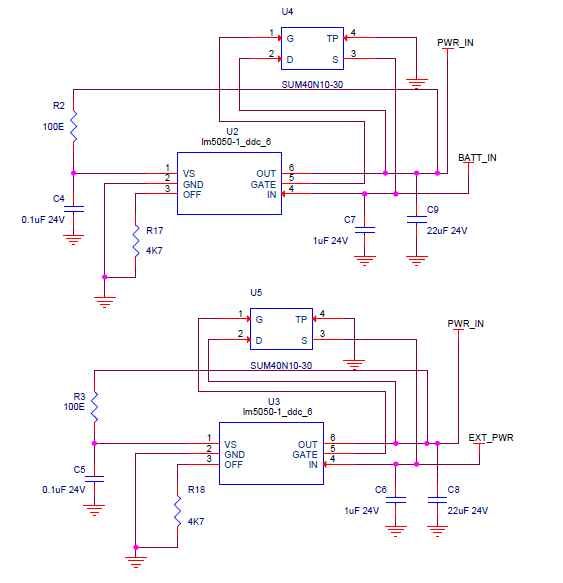

LM5050MK-1EVAL: ORing circuit using LM5050MK-1
Hope this one is clear
I have two power sources and I need to check if I have implemented the power supply ORing properly.
