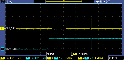

What kind of condition will the RSMRSTB reset?
Plug adapter in, and the system start the power on sequence.
But after SLP_S3B from SOC deassertion, the RSMRSTB of PMIC become low and then high.
Please check below waveform.
The sequence of PMIC seem fine. Only the T6 does not less than 100us.
