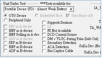

Hi Sir,
My customer use BQ24297 to do BC1.2 compliance and fail.
Pls reference attached file.
TEXAS BC 1.2 test FAIL.pptx
Packet-Master USB-PET Report on Product
Copyright � 2010-2015 MQP Electronics Ltd.
Scripts OTG 2.0 Rel:1.4.1.0, BC 1.2 Rel:1.2.1.7
Test run on Friday, June 22, 2018 10:48:44

[3.615,577]     - IB_UNCFG average was 98.30mA - above ISUSP.
[3.615,586]     - IUNIT was not exceeded before connect.
[4.625,566]     - IB_UNCFG average was 98.30mA - above ISUSP.
[4.625,573]     FAIL: Voltage on D+ (0.009V) is not in range for VDP_SRC.
[4.625,582]     - IUNIT was not exceeded before connect.
[5.635,652]     - IB_UNCFG average was 98.30mA - above ISUSP.
[5.635,659]     FAIL: Voltage on D+ (0.008V) is not in range for VDP_SRC.
[5.635,668]     - IUNIT was not exceeded before connect.
[6.645,656]     - IB_UNCFG average was 266.50mA - above ISUSP.
[6.646,675]     - D+ went high. (Hardware debounce started.)
[6.646,680]     FAIL: IUNIT was exceeded before connect.

[36.943,889] FAILED TEST
===End of Script===============================================
Opening script: CT_PD_REP_DBP.mpet
Compile successful
Checklist for Portable Devices (PDs) - Dead Battery Provision.
DBP1: Does PD draw no more than IUNIT when PD is not
      able to connect?
                                                      - NO (FAIL)
DBP2: Does PD reduce current drawn to ISUSP within
      TSVLD_CON_WKB after attach if it is unable to
      connect and be enumerated?
                                                      - Vendor Declaration
DBP3: Does PD enable VDP_SRC within TDBP_ATT_VDPSRC
      of attach and maintain it if it is unable to
      connect?
                                                      - NO (FAIL)
DBP4: Does PD connect within TDBP_ VDPSRC_CON of
      disabling VDP_SRC ?
DBP5: Does PD prevent the use of DBP current to
      perform tasks unrelated to battery charging?
DBP6: If the PD uses the DBP, can the device normally
      operate stand-alone from internal battery power.
DBP7: Can the PD, with a dead battery, pass the
      inrush test?
===End of Test Sequence========================================
----RESULT SUMMARY----
FAIL - CT_PD_DBP.mpet
Pass - CT_PD_REP_DBP.mpet
===End of Report===============================================

    1. I noticed in the testing reports that you have classified the charger as "[1.263,831] * DCD using current source NOT supported". This is incorrect. The BQ24297 performs DCD with a current source.
    I would correct this first before continuing.
    2. The 1s timing is noted as TSVLD_CON_PWD within the BC1.2 Compliance document and the spec itself. Please refer to that for more information. Additionally, there is a separate TDCD_TIMEOUT that applied to Data Contact Detection, also within the spec. This is up to 900ms max, but can be lower.
    3. TDCD_TIMEOUT also applied to this question. The range for this timer is between 300 and 900ms. Please refer to BC1.2 Compliance Plan you attached to your post.
    Joel H
  • Hi Joel,
    About the first item:
    The Allion Lab reply that they took the default setting to test by instrument  MQP. I had asked to test again with enable DCD.
    Do you know any items I should enable as below?
    Driscoll
  • Hi Sir,
    Do you has any suggestion?
    thanks~
    Driscoll
  • Hey Driscoll,
    I am not familiar with this GUI or how to set up this environment.
    I would imagine that from my comment, the "DCD Current Source" needs to be checked for this testing. However, I cannot explicitly speak to the other checkboxes on that GUI.
    Joel H
