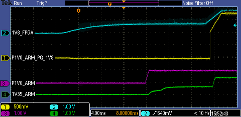

  • Hi Jimmy,
    We had to send the boards out to replace the LMX20502s. We have three boards with the same failures. We replaced the LMZ20502 chips on all three boards, and two are now working and one still fails. We have a few questions that we need your help understanding them better.
    1. This part is starting up in a pre-biased rail. A blog on the TI web site that stated the part is not guaranteed to handle the pre-biased scenario. Can you comment on this?
    2. Can you explain more about the MODE pin (PFM vs PWM)? Would this play a roll in the failure of LMZ20502?
    3. Output capacitance - section 8.2.1.3 Output and Feed-Forward Capacitors, notes that "The maximum value of total output capacitance should be limited to between 100μF and 200μF." Does this include the load capacitance (bypass and decoupling caps) at the chips or just the output capacitors right at the output of the LMZ20502.
    4. EN - We suspect that the buffer which drives this signal might not be powered when the LMZ20502 is powered up. In other words, EN might be floated.
    5. The pictures attached are from a successful power up of the board that failed and was replaced with a new LMZ20502 chip:

  • Hi Howard,
    Please let me know if you still have further questions on this.  If this is still a problem and you see this on multiple units, I recommend sending them into TI for failure analysis at this customer return link.
    Jimmy
