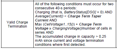

    Below is the valid charge termination conditions that must be met.
    Matt

    I have gone through the Valid Charge Termination conditions several time, and I can confirm that:
    - the batery is charging , DSG=0
    - Average Current: you see from the chart
    - Max (CellVoltage 1-7) + 100mV > Charging Voltage/7, in fact all cells > 4100mV and ChargingVoltage/7=4200mV, so this condition is met
    - the accumulated charge capacity > 0.25mAh. This is hard to confirm from my side. I know that the pack was charging during all the time so I presume it has accumulated correctly. Since I have IPSCALE0=1, I expect that this calculation is scaled accordingly.
    I expect that the two 40-s period to occur one after each after the conditions are first met, but from the charts above it does not seems like that, and this confuse me a bit.

  • Hi Pietro,
    I sent your data to our firmware engineer today to see if he can explain the longer than expected time for RSOC to adjust. I would expect this to be about 80 seconds based on the documentation. Hopefully I will have an explanation tomorrow. Sorry for the delay.
    Matt
  • Hi Pietro,
    I learned that the condition for Average_Current < Taper Current is actually slightly different in the implementation. In reality average current is not directly used. Instead charge accumulated during the 40s window is converted into current and that is used to check against charge term taper current. Most of the time it does not make any difference but sometime depending on charge accumulation it may take more or less time to satisfy this condition.
    I'm not sure if this explains the delays you are observing but it may be something to look at. Can you go ahead and send me your .gg file?
