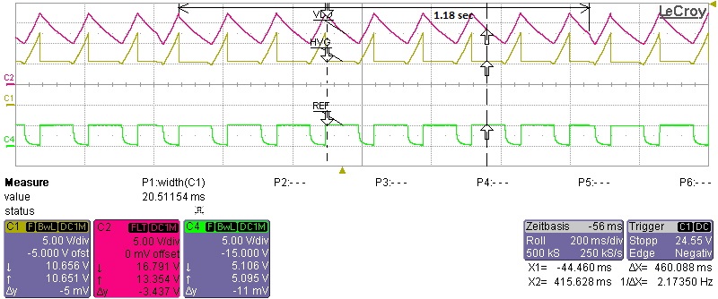

I am using UCC28780EVM-021. It was working properly but suddenly it is not working. I have not changed any components and the pins HVG, CS, Rtz and Rdm are not short or open circuited. I don't know the problem. I am attaching the waveforms. Please help. RUN and PWML not working.
1.  Every ninth discharge time is smaller than first eight discharge times.
In the smaller discharge time, we can see two slopes. Can you give me the reason behind it? The time measured between the first VDDon point after the smaller discharge time, to the point (slope change point) in the next small discharge time is 1.18sec. It is marked in the waveform.
2. Run pin has a small pulse on every cycle when VDD reaches VDDon.

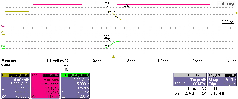

3. This shows the time taken by HVG pin to settle down to 11V.

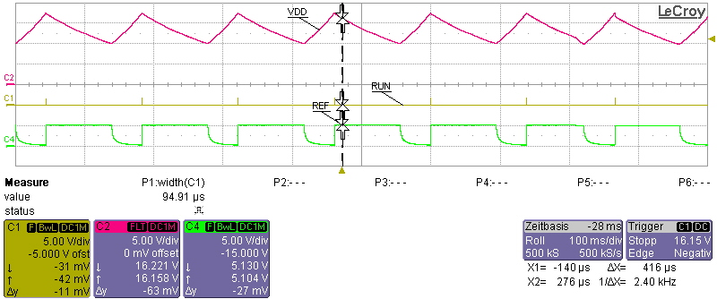

I have also made circuit using UCC28780. As I am waiting for the new transformer, till that time, I am using my old transformer with high primary inductance (695uH). I have calculated Rdm and Rtz according to the 695uH inductance. I am facing almost the same problem with this circuit too. I am attaching the wave forms what I get on my circuit. RUN and PWML not working.
1. Every third discharge time is smaller than first and second discharge times. The time measured between the first VDDon point after the smaller discharge time, to the point (slope change point) in the next small discharge time is 1.21sec. It is marked in the waveform.

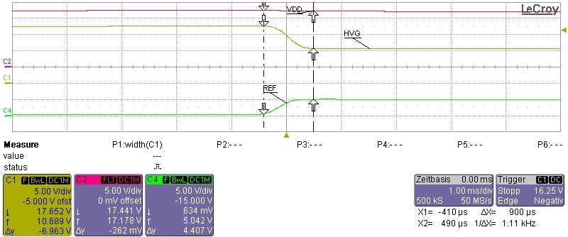

2. This shows the time taken by HVG pin to settle to 11V.

In datasheet section "7.4.10 System Fault Protections" and "7.4.11 Pin Open/Short Protections" various faults have been listed. Can you tell me which faults are being checked during "7.4.8 Startup Sequence"??

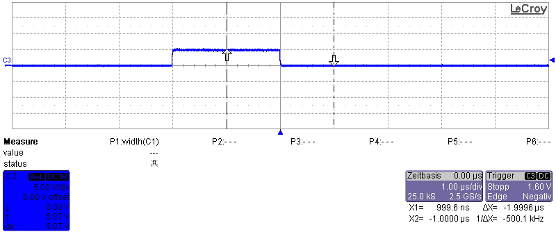

  • Hello Mike,
    Yes you were right. I am getting pulse on PWML when VDD equals VDDON.
    In the following figure (Fig.1), I have marked time 1.18sec. At the beginning of that time, when VDD is VDDon, I am getting only one PWM pulse (Fig.2) of 2us width and 5V amplitude.

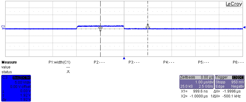

    But when I check the output of the driver at LO pin, I get following (Fig.3) pulse. 2us width but 2V amplitude. What could be the reason?
    Fig.3
