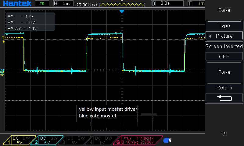

I TRY TO START WITH UCC28070 AND MOSFET DRIVER UCC27524 I HAVE PROBLEM AFTER CONNECT 220V UCC27524 IS DAMAGE SHORT OUTPUT PIN AFTER PUT ON FAST DIODE 1A UCC27524 WORK SOME TIME AFTER PUT LOAD FAST DIODE IS SHORT
WHY MUST HAVE REVERS VOLTAG MORE THAN 1A ON GATE MOSFET ?
HOW CAN RESOLVED

    Thanks for posting the schematic. I think the issue concerns the UCC27524 and not the UCC28070 so I will ask the AE from the drivers team to help support your applications. In the meantime can you post oscilloscope images of the input and output signals of the UCC27524.

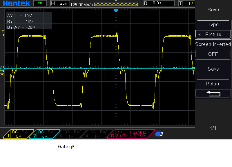

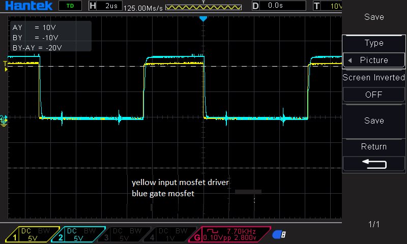

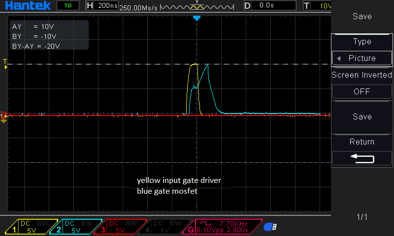

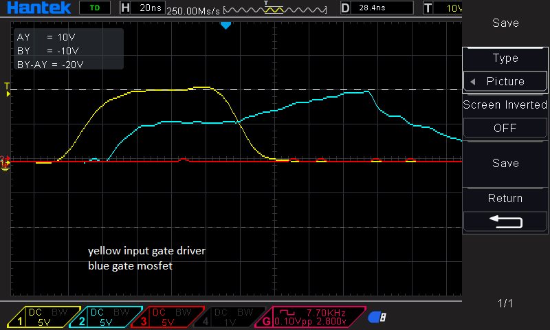

  •       phaseshift.pdfphaseshift-driver.pdfhi thanks for your follow my problem
    r18 and r30 easy can change to 1k bout after connect power I have delay for start to switching pulse
    I test with 60v again ucc27524 fails bout this time diode is ok when work no have any heat on ucc27524
    frequency is 75khz
    in other project I have problem phase shift switching power I attach for you all document wave picture
    transformer 1:1:1 1.5mh in this case r13 r14 is heat and ucc27524 is heat bout working no any fails

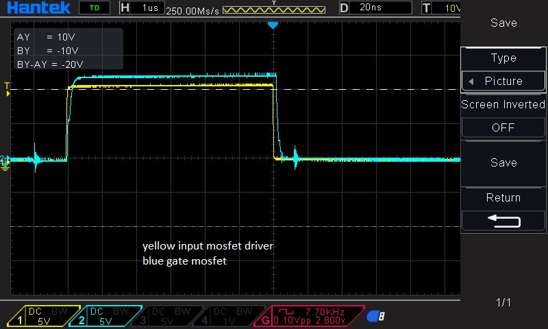

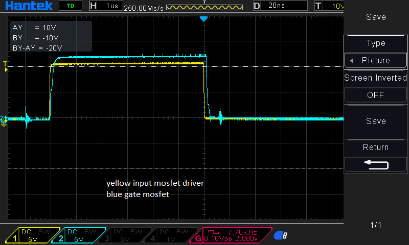

  • hi
    I think this is used full for you better can help to you
    thanks

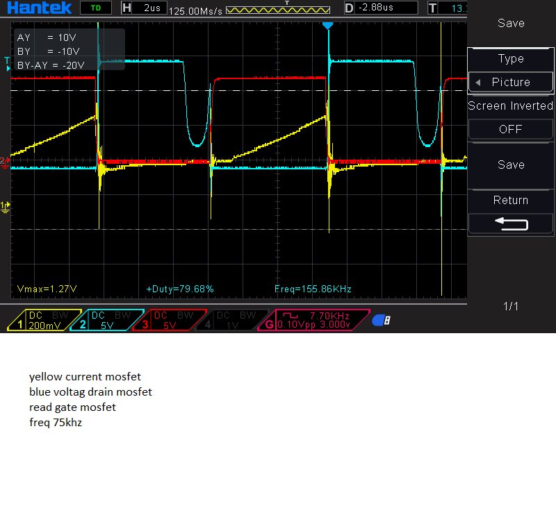

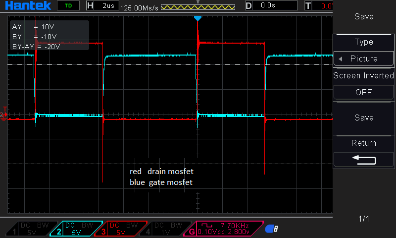

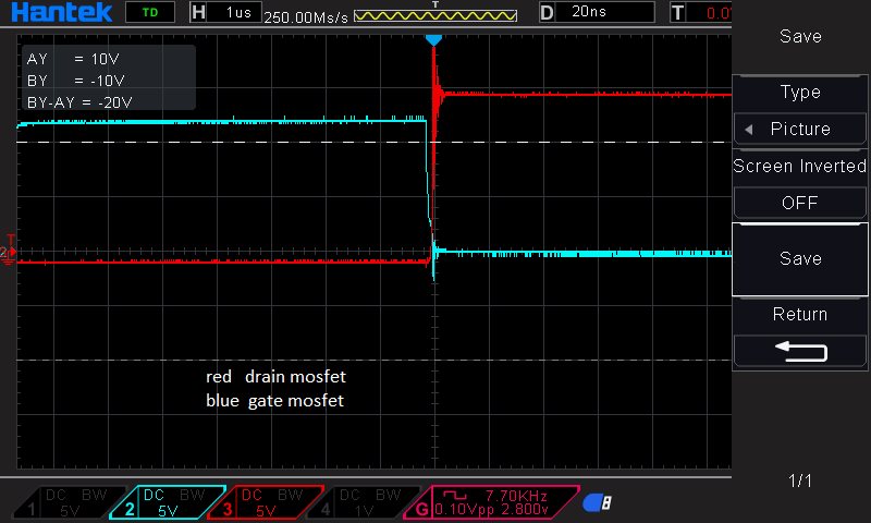

  • hi

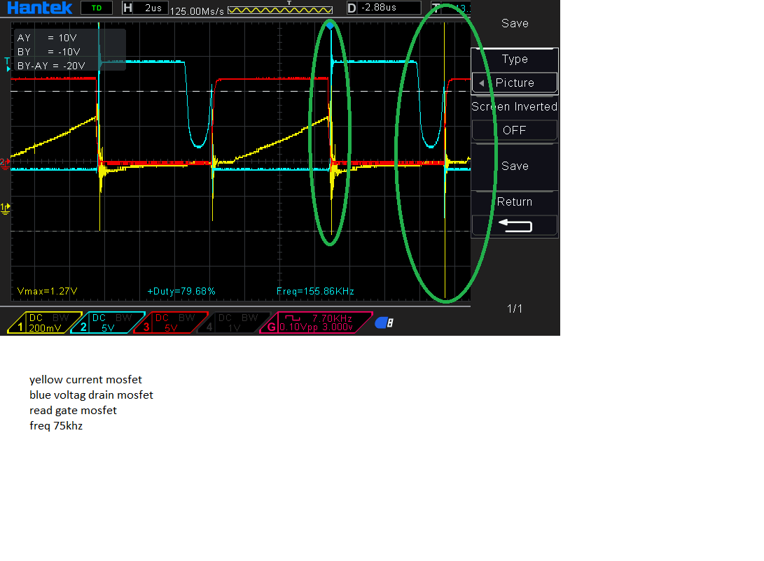

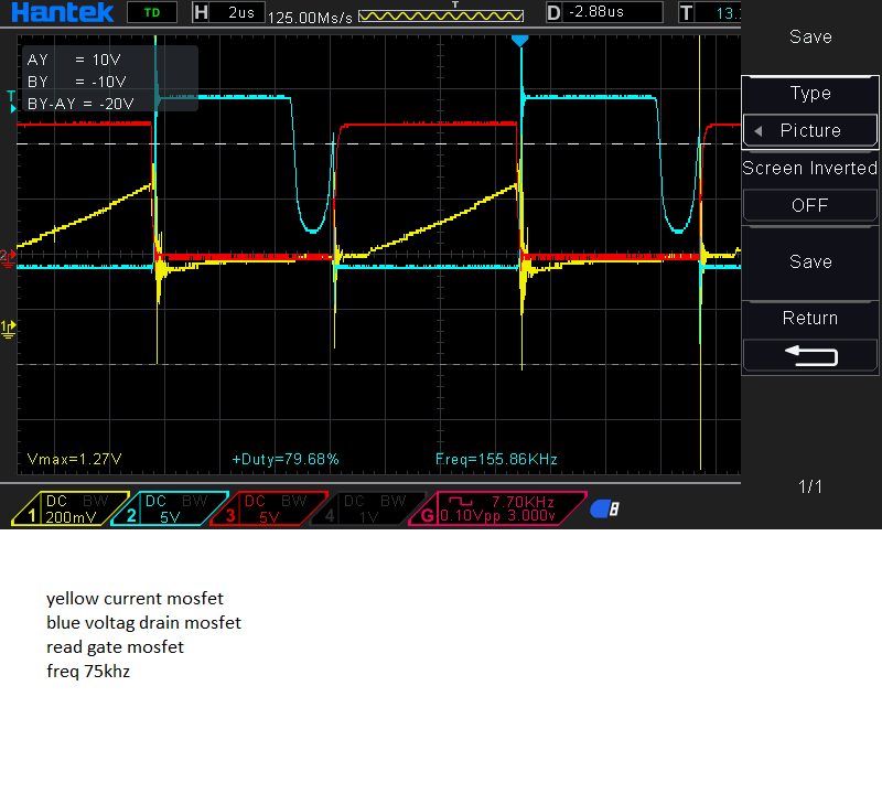

    new happened I try to 132v voltage out pfc test and send wave picture to you all is ok after this try out put voltage to 265 v again get test without load ok load 5.5A ok after try to load 10A ucc27524 one output short to vcc damage mosfet
    q6 and q6.1 is same load and one signal for driver why one is fails other is ok ?
  • Hi Omid,
    Thanks for sharing your waveforms.
    The waveform i attached below is likely due to coupling mismatch of secondary to primary winding which leads to excessive power dissipation that you observed on the driver and R13 and R14. Increasing your gate resistors could help resolve this issue.
    Note that you can determine this resistor value as follow: R >= 2*(L*C)^(1/2). Section 7.1 of this app note copied below discusses this matter in detail.
    www.ti.com/.../slua618.pdf
    -Regards,
    -Mamadou
  • Hi Omid,
    The MOSFET failure is likely due to excessive power dissipation at the junction terminals of the power FET due to simultaneous presence of high Ids current (yellow Ids) and high Vds voltage (Blue) for an extended period (longer than a quick surge). In your scope shots, it looks like Ids (yellow) never starts from ground.
    It also seems like a lot of ringing on Ids current likely due to reverse recovery of the body diode. This excessive ringing could reach high values which in combination with Vds can damage the FET. Consider adding a diode very closed to FET in parallel with the snubber RC circuit you already have.
    -One of the driver's output being also damaged leads to me suspect poor layout likely causing the stray inductance and capacitance. Minimizing the length of high current traces between the driver's output pins and the gate of the power switch is crucial.
    Please let us know if this resolves the issue by pressing the green button or reach out to us for further analysis.
    Thanks.
    -Mamadou

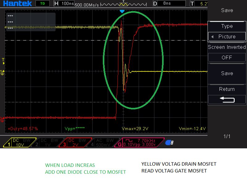

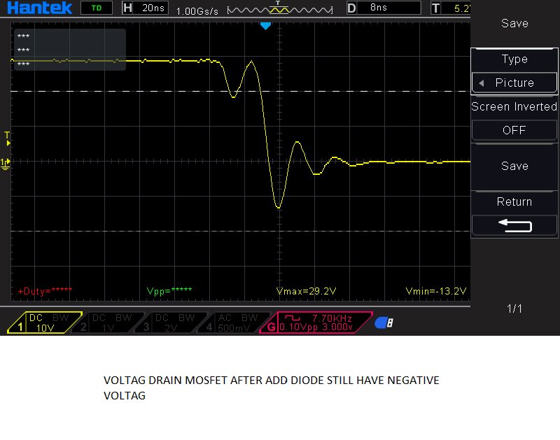

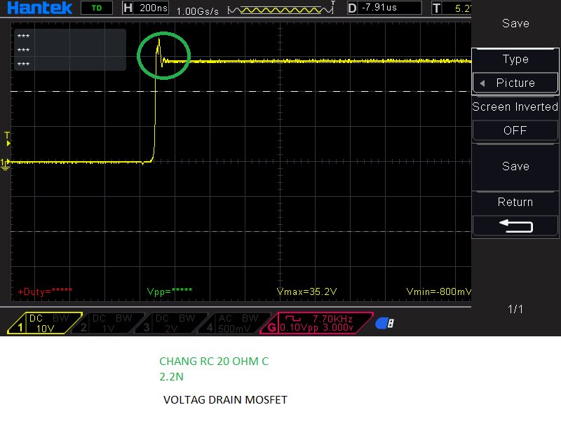

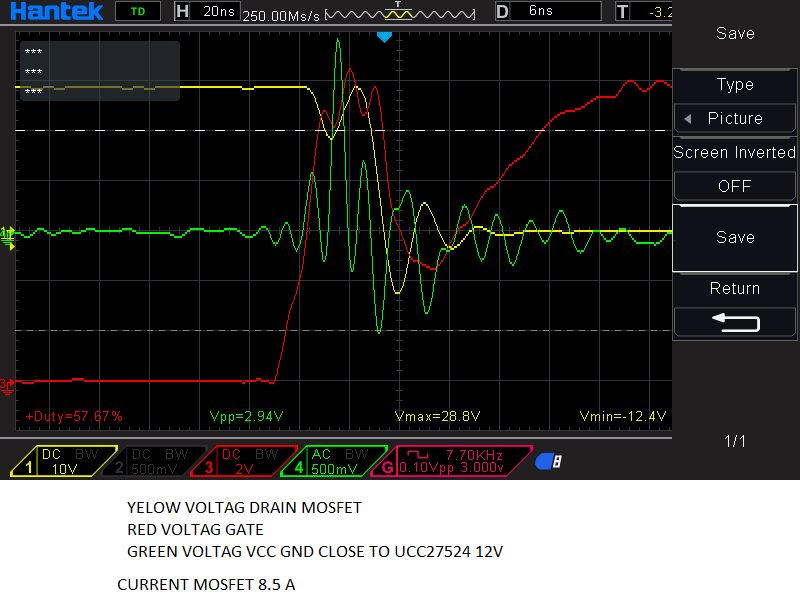

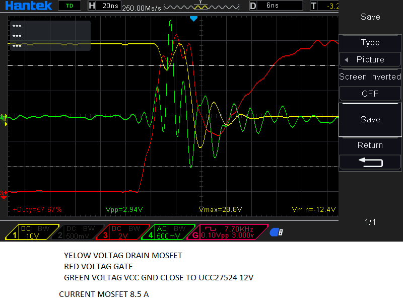

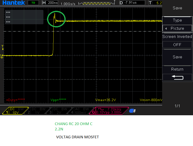

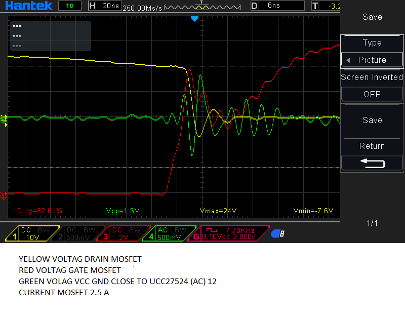

  •    HI
    I TEST DIODE NO CHANGE MORE ABOUT NEGATIVE VOLTAG
    I PUT 22UF CAPACITOR NEAR TO UCC27524 AND CHANG RC TO 20OHM 2.2NF
    I ATTACH PICTURE FOR YOU

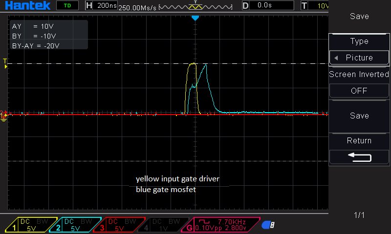

  •   HI
    I GET VOLTAG VCC AND GND CLOSE TO UCC27524 HAVE SOME RIPPLE ON DC VOLTAG WHEN SWICHING IS ON OR OFF AND WHEN INCREAS LOAD P-P VOLTAG IS INCREAS
  • Hi Omid,
    That is quite a bit of ringing going on. WHat you're experiencing is related to the effects of parasitic body diode reverse recovery on the mosfet (which is not optimized). It also explains the undershoot on the Vds and the noise on Vcc because the system is now susceptible to EMI noise. This is causing ringing on Vgs and losses with Vds and Ids overlapping (though you're not showing Ids).
    You're also switching too hard creating high dv/dt and di/dt. This large di/dt coupled with parasitic inductance in pcb layout will slow down switching transitions.
    Please increase gate resistance value (I noticed you only had Rgate = 5 ohm in schematic) to reduce dv/dt and di/dt, this will decrease turn on/off of the MOSFET.
    This should resolve the issue. If it does, please press the green button or let us know for further debug.
    -Mamadou
  • HI Mamadou
    i attach for you ti shematic for 3kw
    no have rc on mosfet and gate 5.1 ohm only for remind you
    i change R gate to 20 ohm and rc r=20ohm c=4.7N  still undershoot have bout lower than 5 ohm
    again change 33 ohm undershoot around 20v bout temperature mosfet go up around 10 degree after this try test with low inductance when L/3 with 20 ohm good effect
    bout efficiency 5% down
    under shoot
    i think this problem searching on ucc28070  must select suitable duty on load when duty is high energy more save on inductor and make under shoot when mosfet turn on still inductor have current make switching hard

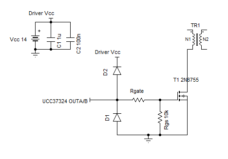

  • Hi Omid,
    Sorry  you're still having trouble.
    I agree, ucc37324 is set up correctly, I don't see any issues related to the driver from the schematic shared.
    Before I pull the technical experts from ucc28070 team though, have you tried the configuration below?
    I know you already Rgs and Rgate there but the clamp diodes as shown might help with the gate malfunction.
    The gate going high before coming down just to go high again tells me something not right there.
    Also, I want to add a 0.1uF cap to help with the filtering.
    If you're still having issues then, i would suspect UCC28070 and the duty cycle at full load.
    At that point, we will pull technical experts from ucc28070 team to help debug further.
    Thanks for your patience and perseverance.
    -Mamadou
  • HI
    THANKS
    I WRITE FOR YOU BEFORE I ADD 10UF AND 0.1UF AGAIN (HAVE ONE SET ADD ANOTHER) TO VCC AND GND AFTER THIS EFECT SOME BETTER (WAVE VOLTAG EFECT GOOD BOUT NOT COMPLETED RESOULVED )AND NO FAILS UCC27524
    ABOUT D1 FIRST NO HAVE BOUT AFTER FAILS IN 220V I ADD D1 WITH HAND NOT SHOW IN SCHEMATIC AFTER CAN WORK WITHOUT LOAD ON 220V IN FUTHER ADD 1N4148 FOR D1 AND D2
    NOW MY PROBLEM IN HEVY LOAD SURE UCC27524 NOW SETUP CORRECT OTHER PROBLEM ON UCC28070 MUST FINED
