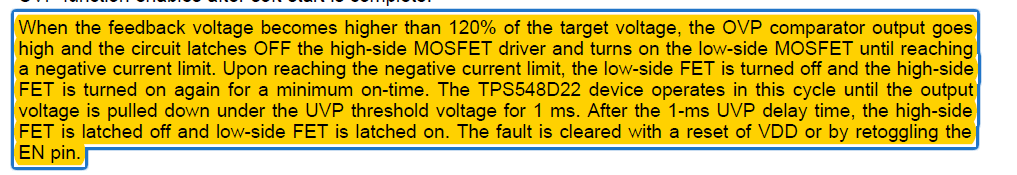

I am curious about a problem: the TPS548D22 OVP circuit only reaches a minimum on-time after reaching the reverse maximum current limit, which makes the TPS548D22 enter the UVP state, which is equivalent to extending the OVP time, which is not conducive to the next startup of the TPS548D22. . What is the purpose of this design?

  • Hi Olin,
    We design the OVP circuit this way to protect the IC from damage due to high negative current, particularly if the inductor become saturated. The 1ms delay at UVP threshold voltage is to alleviate the VOUT negative ringing which can potentially damage the IC as well.

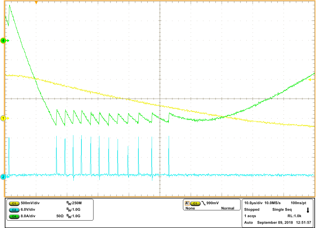

  • Hi Amnat,
    The figure shows the OVP of the tested TPS548D22EVM. The actual measured delay time at UVP threshold voltage is not about 1ms, but about 35us. Can you explain this situation?

  • Hi Amnat,
    I am also working on 548D22 because I am going to test newly-generation one.
    Related to issues in 548D22's OVP actions, I think it could be better if you can explain those actions in more details. Besides, I also have some questions related to this if you do not mind.
    1. From Olin's last testing waveforms, I can see Negative current limiting triggers when negative current is app 35.2A, where the point is not right coz the set negative current limiting point shall be over 40A. What is the cause?
    2. The second one is high-side MOSFET's off-time after UVP threshold is triggered is increasing, leading to negative current increasing again, does it means that high-side MOSFET would not be activated after negative current reaches negative threshold?
    Thank you for answering me those questions.

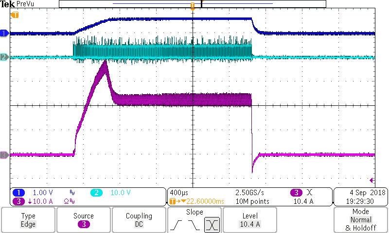

  • Hi Amnat,
    I can explain this.
    1. If FB node was included, some noise will be injected by probe loop which cause control unstable.
    2. Normal operation, the OCP threshold is 40A, which is shown as latch-off waveform below.
    If there is anything making you confused or want me to check again. Please ask me whenever you want. Thank you for you patience.

  • Hi Wenhao,
    From the look at the valley current of the OCP threshold, it's pretty similar to the negative OCP valley value (~35A).  This is a normal operation.  I have nothing more to ask.  I'm glad the report is useful for you.
