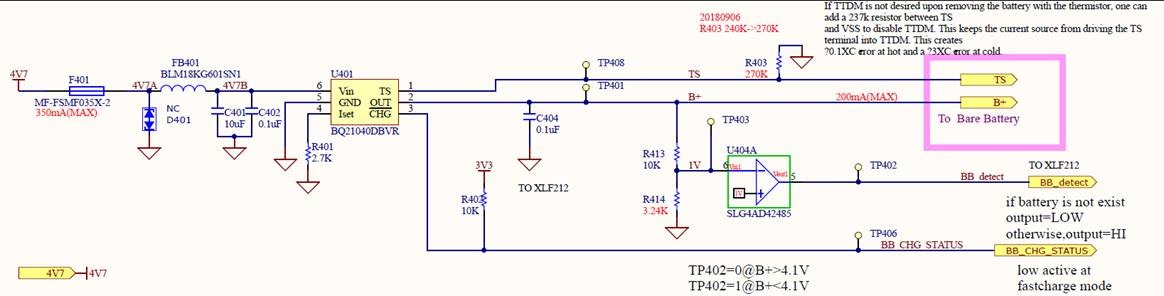

BQ21040: Issue: /CHG doesn't goes low when battery insert
Part Number: BQ21040
Hi TI,
Thanks for your previous response.
Now I know /CHG will goes low when battey insert even in TTDM mode.
In our device, /CHG doesn't goes low when battery insert.
1. If AC is present, /CHG doesn't goes low when battery insert
2. If insert battery first then insert AC, /CHG goes low
  • Have you tested with the Ti EVM?
  • Hi Bill,

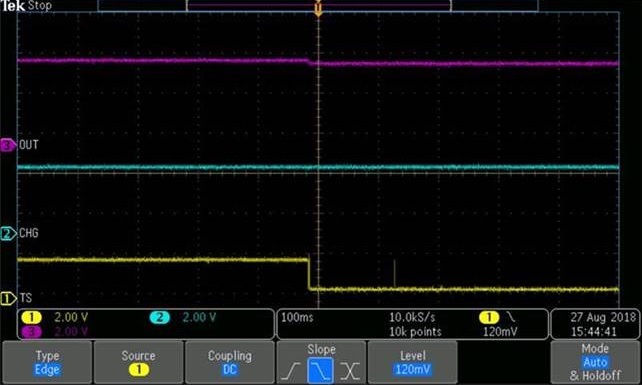

    Customer has no EVM for testing by now. And we have to add a resister from Ts to GND, then can get /CHG high to low while battery insert.

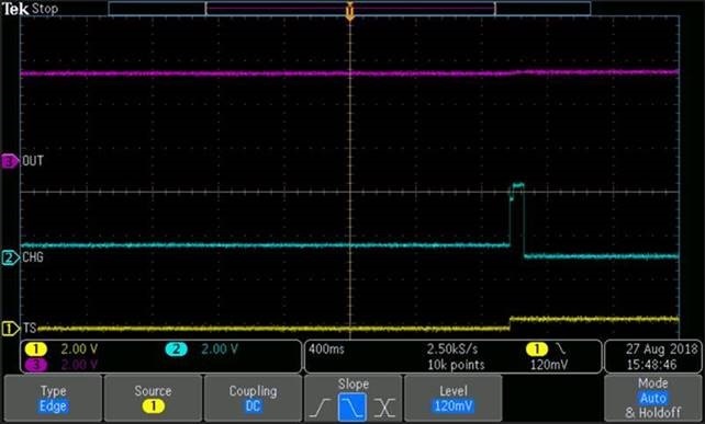

    But sometimes /CHG still stay low when battery remove, we have to touch it by probe then /CHG goes high.
    Here's the question:
    1. Why we have to add resister from Ts to GND, then can get /CHG high to low while battery insert?
    2. Why keep TS floating, /CHG still keep high when battery insert
    3. Why we add a resister from Ts to GND, sometimes /CHG keep low while battery remove (if we touch the pin with probe, then it goes high)
    BTW, here's the schematic for your reference.
  • Hello
    1. Why we have to add resister from Ts to GND, then can get /CHG high to low while battery insert?--Bill J - is this a 237k resistor to disable TTDM mode or 10k resistor to simulate NTC?
    2. Why keep TS floating, /CHG still keep high when battery insert--Bill J - This would be TTDM mode. In this mode does /CHG go low if battery is inserted then (V-in ) AC is cycled?
