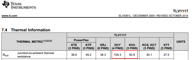

Recently my customer has needed thermal information of LM317MKVURG3 KVU-package. The answer for this question was found here
After that the customer found some interesting details:
SOT-223 has ThetaJA=60,2 C/W
TO-252 has ThetaJA =56,9C/W,
As can be seen, the value is almost equal to each other.
By the way, the customer noticed that the value of same options of TLV1117 are different
On Semi's LM317M. The difference of value is even greater. (My customer knows that TI and OnSemi calculate this characteristic in different ways, so he compares the parameter within one manufacturer)
Tell me please, are the following data correct?
ThetaJA = 56.9 C/W
ThetaJC (top) = 36.1 C/W
ThetaJC (bottom) = 1.8 C/W
ThetaJB = 29.3 C/W
PsiJT = 3.8 C/W
PsiJB = 28.8 C/W
and, whether there is an error in the reply on the link above?
Thanks in advance!
  • Hi Aleksandr,
    The data populated in each datasheet is correct for the datasheet given.
    For TLV1117 ThetaJA is 104.3 C/W for the DCY package and 50.9 C/W for the KVU package.
    For LM317M ThetaJA is 60.2 C/W for the DCY package and 56.9 C/W for the KVU package.
    There are a variety of factors that impact the thermal performance of a device including leadframe, die size, die placement/orientation in the package, mold compound, and more. While the type of package has a large impact on thermals, due to the other factors, there can still be a large variation between two devices in the same package.
    The Thermal Information table is populated with data modeled following JEDEC's EIA/JESD51-x series of documents. The TI interpretation of these measurements can be found in the following Application Report. As you stated, not all companies calculate these metrics the same way.
    www.ti.com/.../spra953c.pdf
    Very Respectfully,
    Ryan
