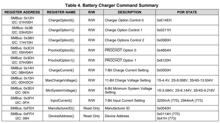

Did we have MSP430FR2153 reference code for BQ24770?
Or we have other MSP430 code for this device?
If we have, could you share with me? Here is my mail address. benkuo@ti.com
Thanks~!
-Ben
  • Hi Ben,
    As I know we didn't have code for MSP430. I think the firmware code should be easier for BQ24770 because internal registers are less. see below table.
    In general case, customer only program REG0x14 and REG0x15 can enable charger function via SMBUS or I2C  interface.
    The other fine tune setting will be depended on customer's system design.
