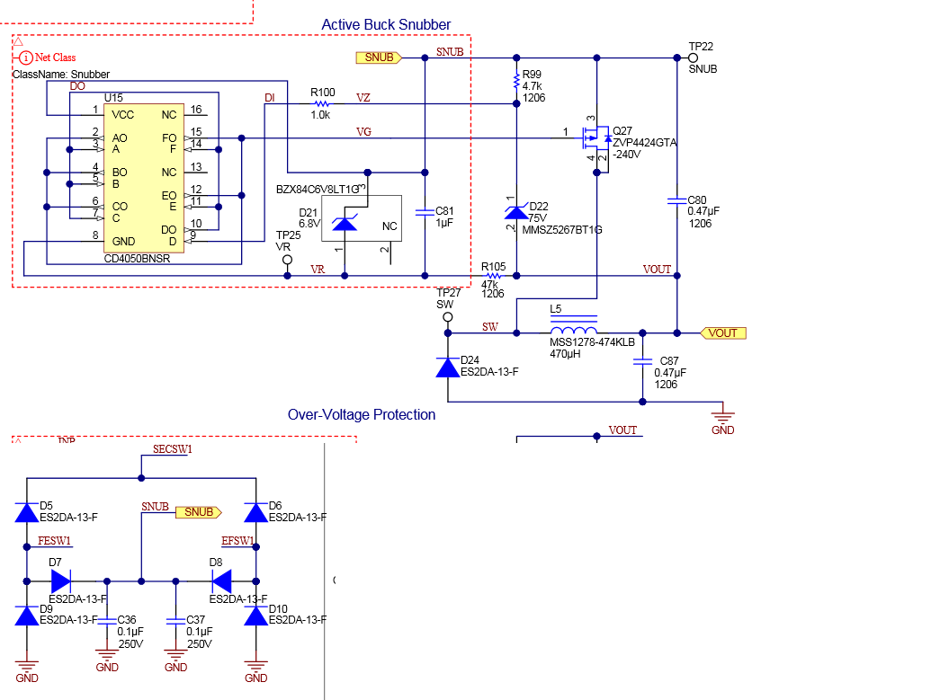

Hi All,
My name is Mert Karadeniz an electrical engineer works on Power Electronic Circuits in Germany.
I have the same question of the operation principle of the circuit given above. Can someone briefly explain me how does the active snubber with hex buffer, P-MOSFET and zener diodes work?
Thank you very much.
Kind regards,
Mert.

  • Hello Mert
    Thanks for sending me the email - I've replied directly to you but I'm updating this post as well
    From what I can see the CD4050 simply acts as a buffer and MOSFET driver which turns Q27 on when SNUB gets ‘too high’ and turns it off when SNUB gets ‘too low’. This action is hysteretic, controlled by the thresholds of the hex inverter alone. Q27 / D24 are the buck switching elements and L5 is the buck output inductor.
    C81/D21 give a regulated VCC rail for the hex buffer – actually it’s really a single non-inverting buffer because all the individual buffers are paralleled.
    R105 drops most of the voltage between VOUT and the cathode of D22 – the current is low of course.
    SNUB is a DC level regulated at about 130V by the Active Buck Snubber. The basic outline is in the attached document along with some waveforms.
    I’m afraid I haven’t actually seen this circuit before and I don’t have a PMP6712 device here to work with. I would have to run some simulations to give more details and that might take some time.
    At a top level. The snubber stores energy at about 130V in C73/C72/C36/C37 and the buck converter down converts this to VOUT – synchronously with the main power train.
    I’m not sure why the designer chose this method to control the buck active snubber but of course there are always different methods to achieve the same result.
    Please let me know if this answer is sufficient
    The full PMP6712 schematic is available at http://www.ti.com/lit/df/slura08/slura08.pdf
    Colin
