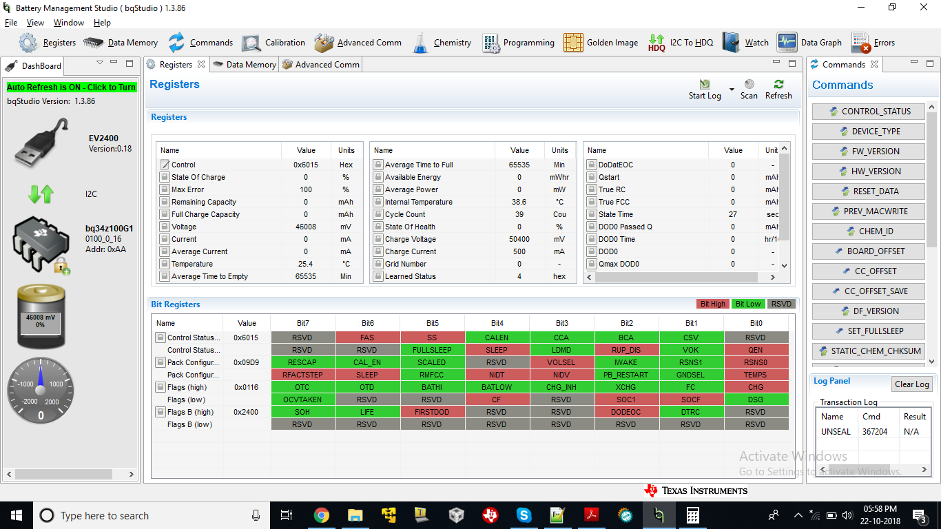

    We have completed the learning cycles, but still state of charge is 0% and error is 100%.
    Also we are unable to change design capacity.
    Please let's know if we are doing any thing wrong.

  • Hello Bryan,
    Thanks for the reply.
    I had set voltsel bit to 1, Voltage calibration is done properly, Voltage and current reading shows correct, CHEM ID is updated, but when i try to change device capacity, it is not changing, Device capacity shows 1000 mAh.
    Viraj Cholera
  • Hi Viraj,
    Please ensure the device is in an unsealed full access state prior to writing the design capacity to data memory. First unseal the device (state as shown in the screenshot), then perform the unseal full access command.
