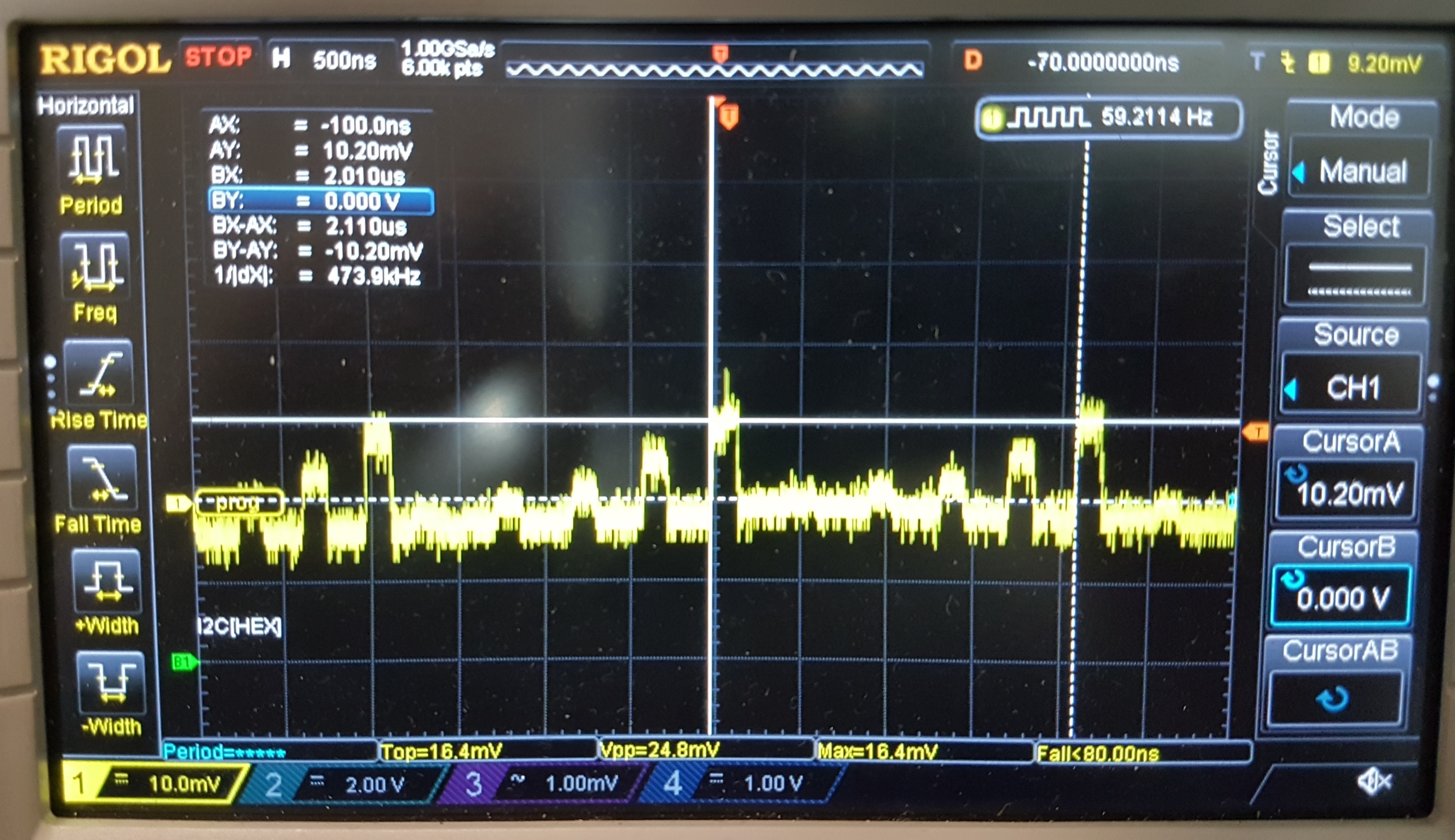

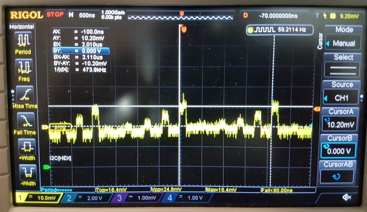

I dont seem to be reading the correct value for READ_IOUT using a TPS53667 wired up for 5 phase operation.  CSP6 is connected to V3R3.
RImon is 49k9, and R's for F-IMAX are 33k2/30k1.  Register 0xDA (MFR_SPECIFIC_10) is reading as 121, so seems that F-IMAX is correct.
The 0x8C register is reading as 0xB800.
I would guess that Iout is something like 5A.  Vin and Iin are reading correctly.  0x39 (IOUT_CAL_OFFSET) is also reading as 0.
Thoughts?  Happy to share schems offline.
