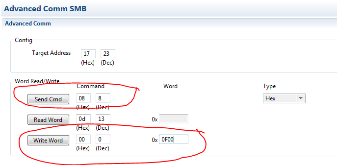

    1) How can BQ40Z50 enter the ROM mode? And how can it exit the ROM mode?

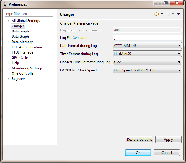

    2) I set XL to 1 and RESET the fuel gauge. Now I can't use EV2300 to change XL back to 0 with bqEVSW. What should I do to switch my BQ40Z50 back to normal mode.
    3) Could you please recommend a battery fuel gauge which can support 400kHz fast mode when running FW?
  • Hi Chang,
    1. To enter ROM mode send a Word write to 0x00 with word 0x0F00 and to exit ROM mode send the command 0x08:
    2. To switch the mode back, you will need to make sure that you are using the "TEST" version of bqStudio (v1.3.86.3) that you can download from the http://www.ti.com/tool/Bqstudio . Under preferences->Charger, you can then select the High Speed EV2400 I2C clock that should allow you to talk at the higher speed and change the XL bit back to 0:
