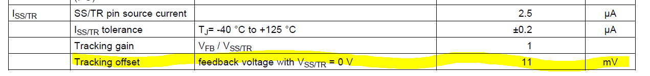

I need max value of ISS/TR Tracking Offset which is defined only TYP as 11mV like the below figure from the datasheet.
Is MAX value available?

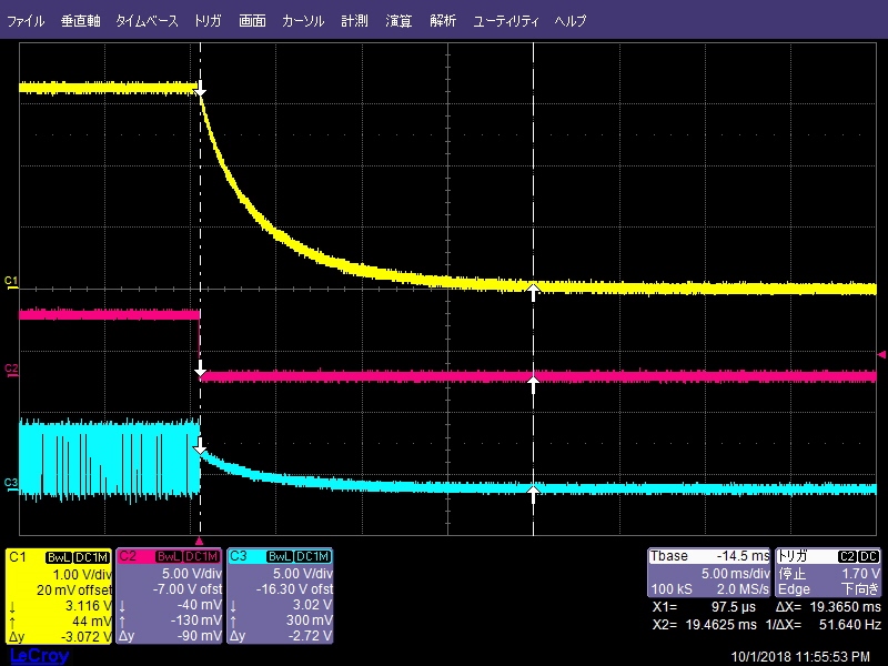

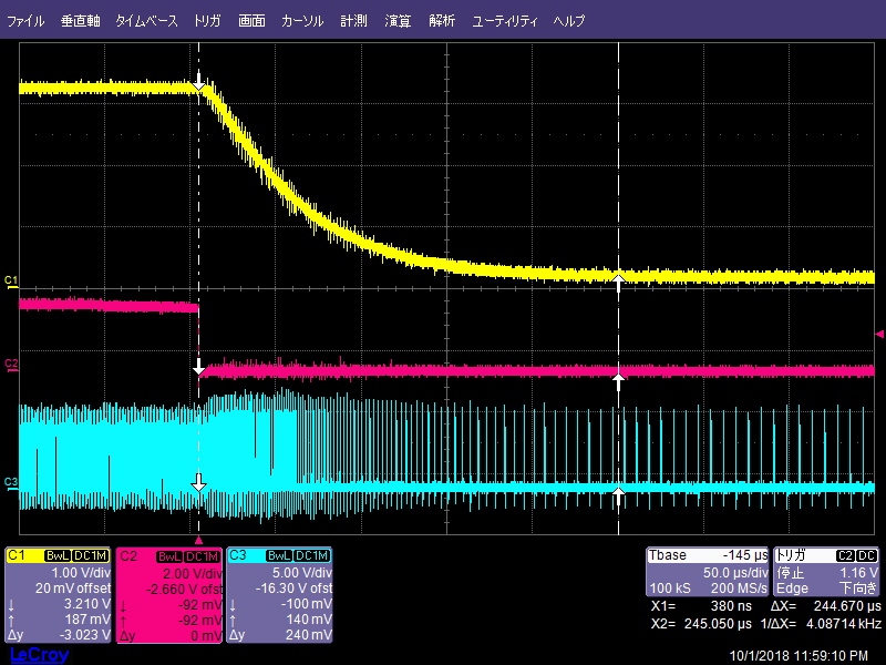

    Due to power down sequence requirement of a device, TPS62136 output voltage have to go down to 0V within about 500usec.
    As far as I tested, using tracking pin can shut down very quickly, maybe within 300usec although some offset voltage remains..
    But when using EN pin, it took over 10msec. So I’m looking for a way to use tracking. Is there any way?

  • Thanks for explaining Oba. What is the load during this shutdown time? If you disable the IC, the load might bring Vout down faster.
    Do you have a waveform of EN, Vout, SS/TR, and SW as it ramps down?
    I put the waveform below. 1st one is using tracking case, 2nd one is using EN case.
    In both cases, the load is almost 0.
    CH1(Yellow):VOUT, CH2(RED): SS/TR, CH3(BLUE):SW
    CH1(Yellow):VOUT, CH2(RED): EN, CH3(BLUE):SW
    I have to assume the load current is almost 0 during the shutdown.
    Because the load IC is reseted during shutdown and also
    I don’t want to design depending on the load current to fix the shutdown time.
    Is there any way to solve this issue by this device level.
