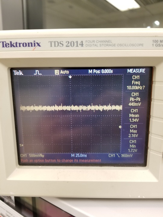

  • One issue I found is that the LED switch on (no blinking) even I did not connect the battery. My expectation is it should detect the battery absent and the LED blink.
    Then I check the voltage waveform at FB pin, I got the following result.

  • Gary,
    For battery detection, when the battery is not connected,
    1. How much total capacitance is connected to VBAT (charger output)? Please compare with Cmax below.
    2. Is there any load connected to VBAT?
    Ning.
