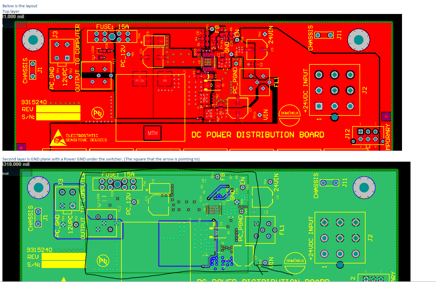

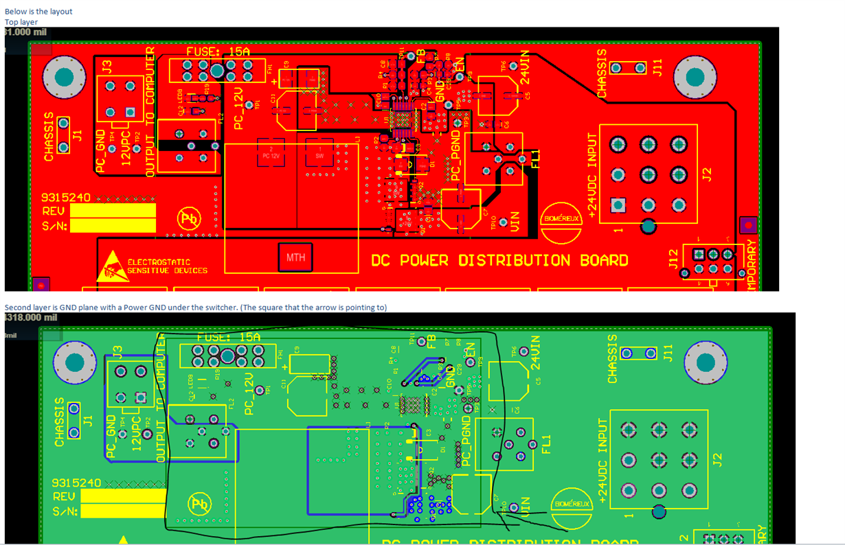

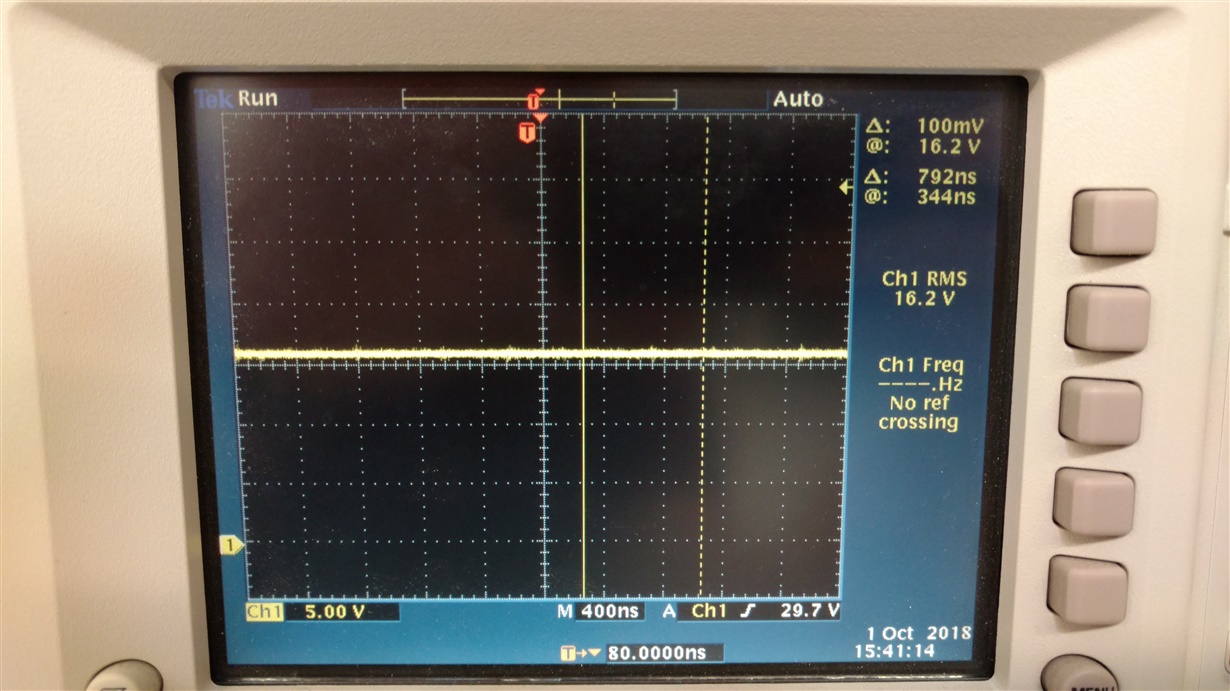

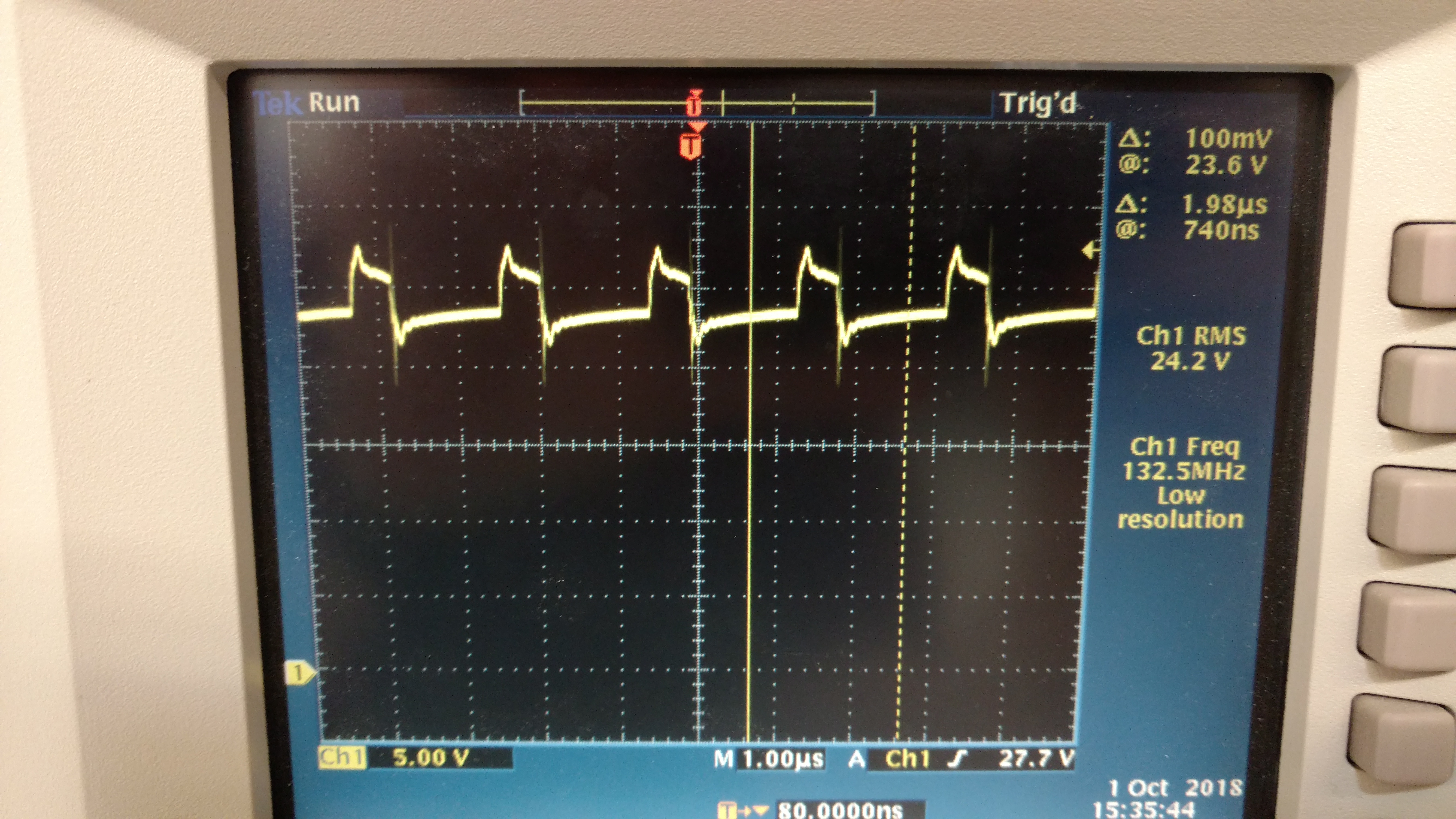

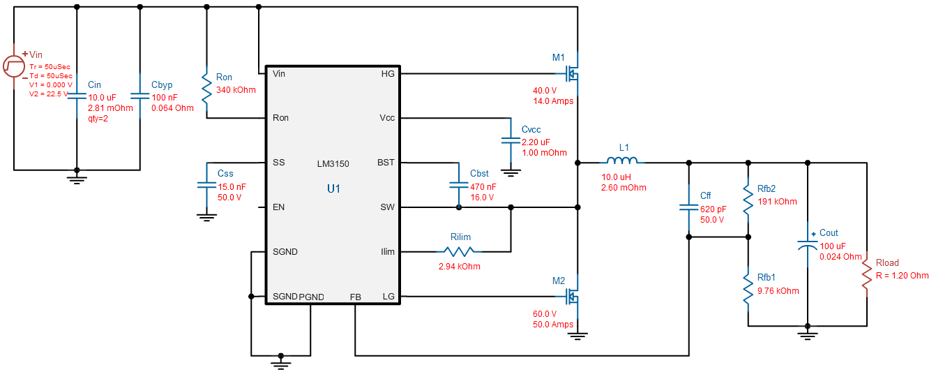

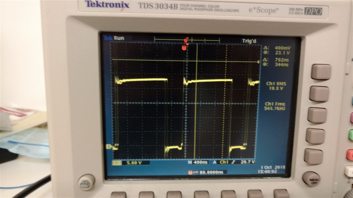

Using the circuit provided by Webench our prototype is not performing as expected. It was designed for a 24VDC input and a 12VDC 12Amp output. As soon as we add a load on it the Voltage drops from 12V to 10V and our input capacitors get extremely hot.
The input power supply is 1000W with no current limit. Below is the schematic of the design.
