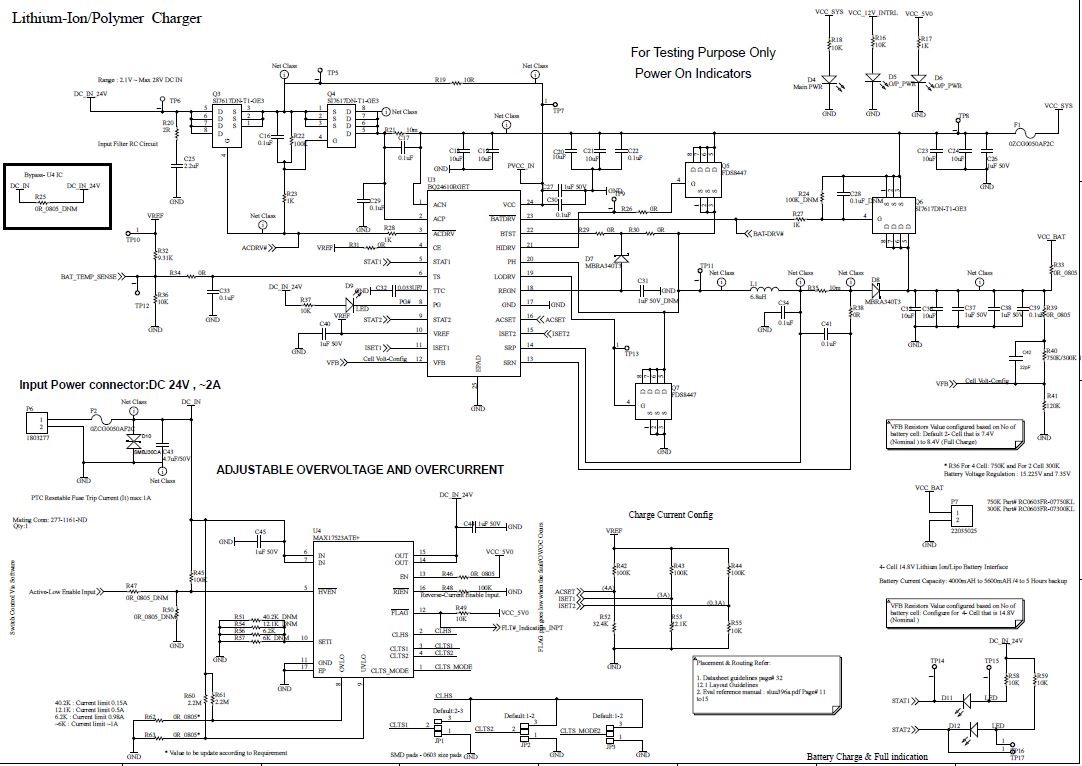

   We have used BQ24610RGET battery charger IC in our design, we noticed that Battery is not charging properly and in my design STAT1 led is contentiously blinking and battery charger cut-off is also not happening.In that
            Input voltage     =  24v DC (From Adaptor 24v,3A).
            Battery Voltage = 14.8V(Nominal) to 15.8V(Full charge).
            Vref                     = 3.3v
            REGN                 = 6.0V
            PG                       =  LOW
current battery voltage is 13.3V.
But still STAT1 led(D11) indication  is Blinking.
Here i attached the schematic here.
