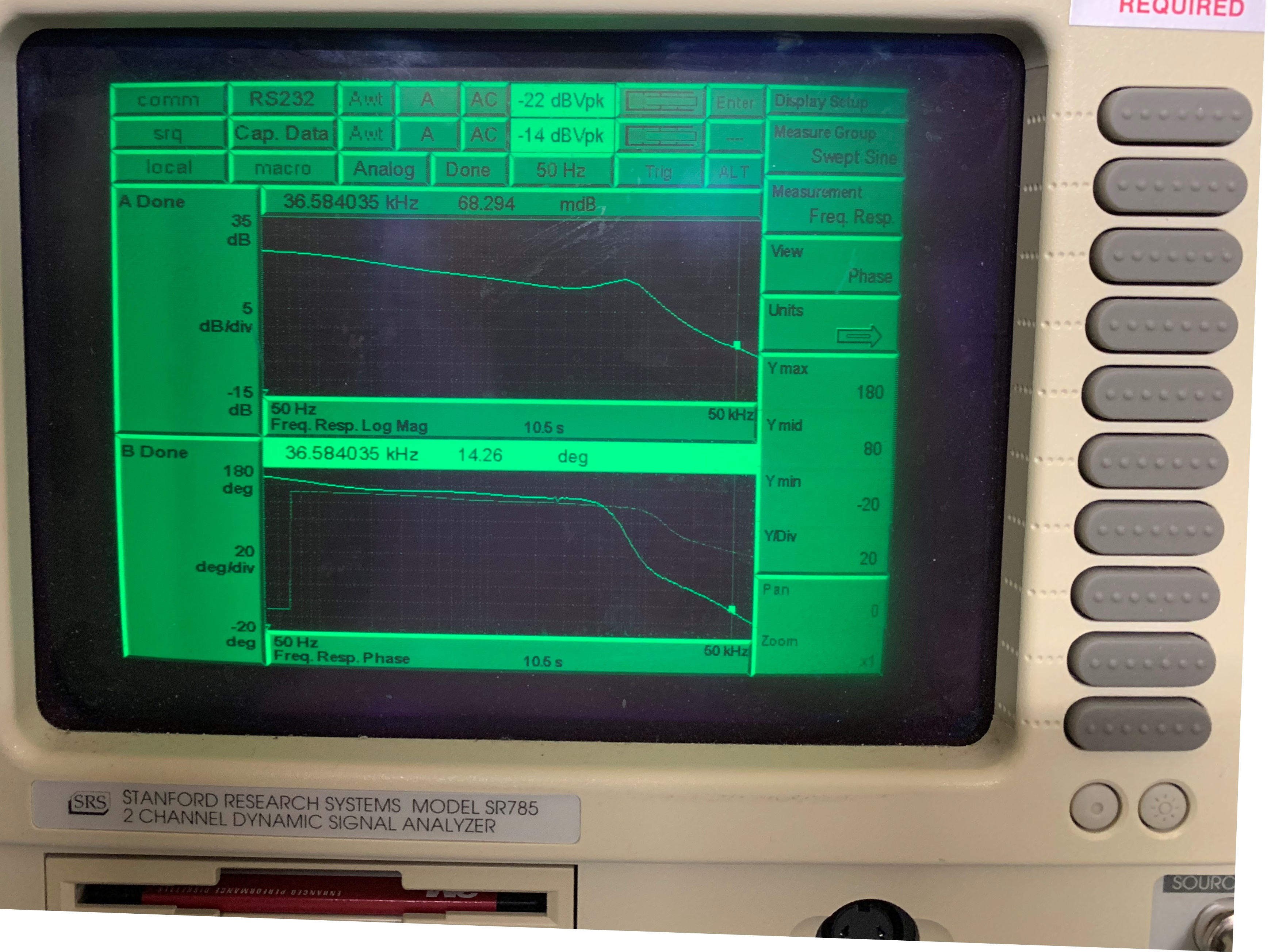

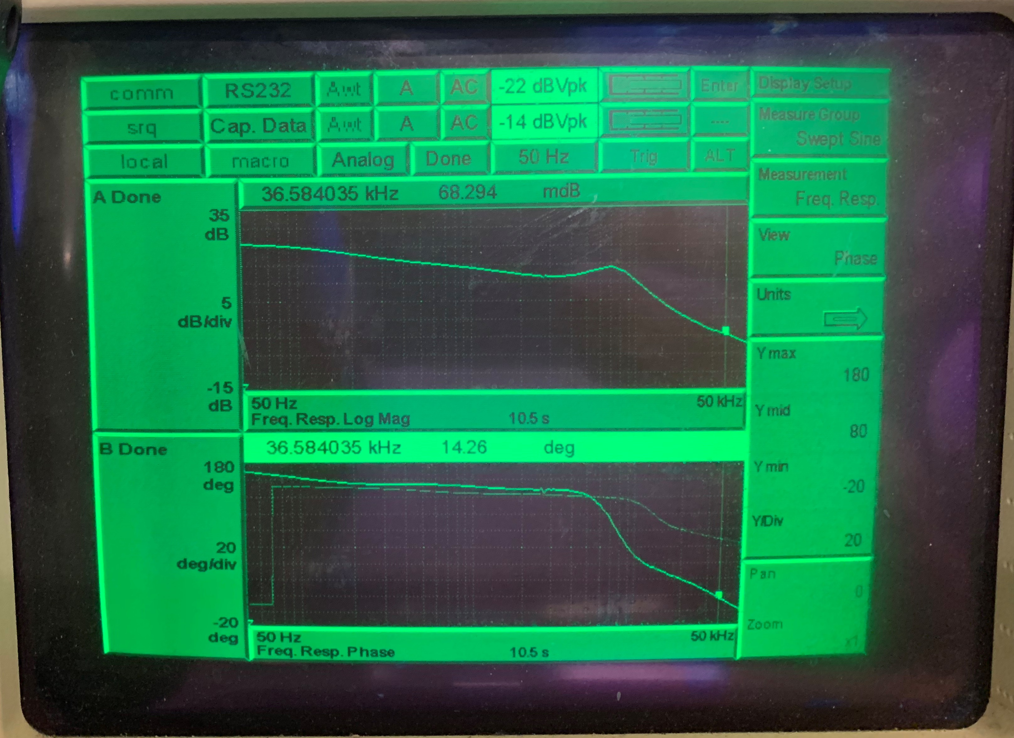

Attached is page 25 of the UCC39002 User guide. I marked up the schematic with the latest values that customer has been testing the evaluation board. I also attached the datasheet of the power supply that Ihe is trying to get the current sharing to work at full capacity. At this time the best he  can do was to 5.1A at Module 1, 4.7A at module 2 and 4.5A at module 3. If he trys to get more current, the brick would go into hiccup mode.
He measured the internal pull up on the SP7753 across the +Sense pin to the +Output pin and it is 100 Ohm. He also made several scan of each module for the Band width and the lowest was 36kHz. With these values, hecalculated for R (Adj), C(CEA) and R(EAO).
