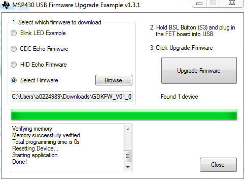

I am writing because I would need the latest fwd image for the GDK (MSP430) needed for step 6.10.3 of SLUUAO1A. Could you please share a working link?
The one that is in the guide contains the EV2400 Updater App.
Thanks.
  • Hi Leinho.
    Update the firmware on the gdk by downloading the msp updater below.. the .png image shows what the updater looks like. Plug in the gdk and then from the updater navigate to where you saved the file GDK_V1_06_INA220.txt and then update
    http://software-dl.ti.com/msp430/msp430_public_sw/mcu/msp430/MSP430_USB_Developers_Package/latest/exports/MSP430_USB_Firmware_Upgrade_Example-1.3.1.1-Setup.exe
    @4400

  • Thanks Onyx. It worked but is it possible to check the fwd version of the GDK with bqStudio?
    I tried with the "Commands" tab but the response does not make sense to me.
    I have only the GDK connected (both USB and power) and I can see in the dashboard that the fwd version of the EV2400 was successfully updated to v 0.18.
  • unfortunately no it is not possible.
