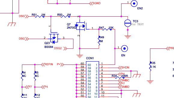

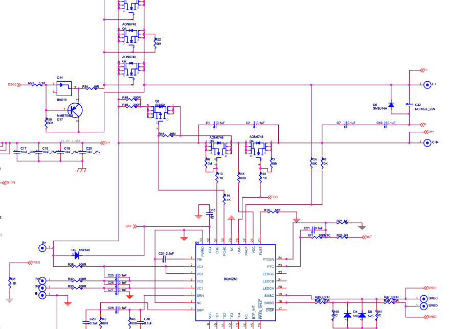

Why PACK CUV protection funtion did not work ?
    My circuit design as below:
    Charge and discharge circuit is separate,p+ is connected PACK Pin with R56(10K),CH+ is connected PACK Pin with R8(10K),
    if R56 did not weld,CUV protection funtion did not work,p+ did not turn off.
    if R56 and R8 all weld,CUV protection funtion did not work, and p+ turn off immediately then open again. please see the attachment video.
     if R56  weld,but R8 did not weld, CUV protection funtion work normal.
Why is that? Thanks!
