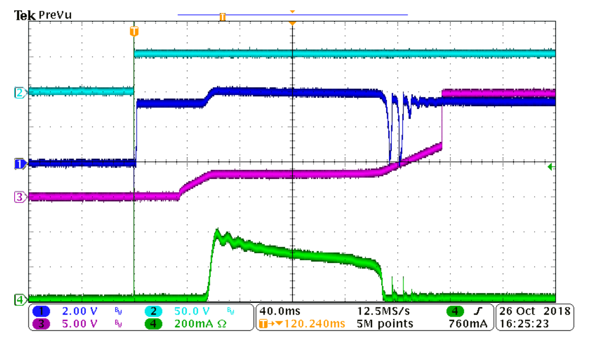

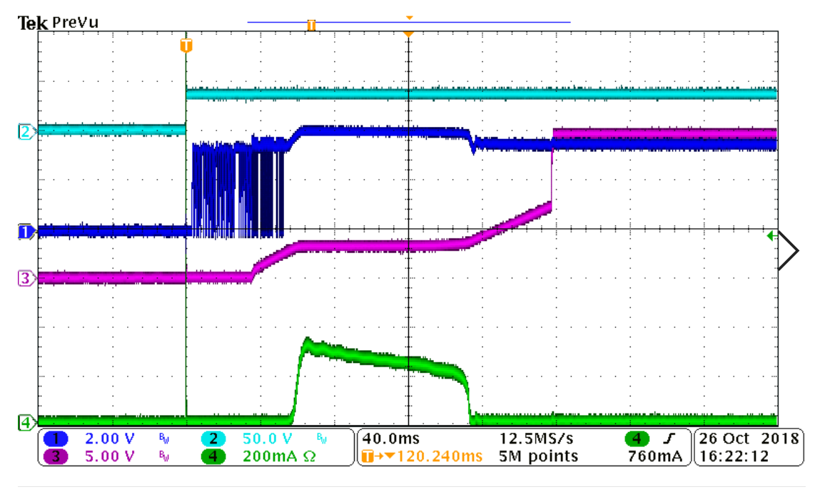

While testing startup waveforms of our EVM, I found 23523 will enter normal operation mode when
When I test GATE2 as well as GATE. It has been mentioned that it is after GATE reaches 7.5V that GATE2 starts to rise. Thereafter, GATE will start to rise steeply with ~1ms delay.
In addition, it is really apparent that BGATE has a lot of drops during start up and quantities of drops are related to VIN.

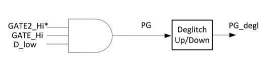

(1)Please kindly give a comment on that 1ms delay between GATE2 reaches 15V and GATE reaches 15V. Does GATE=7.5V means GATE=Hi?
(2)Please kindly give a comment on BGATE delay during start up.
Thank you very much!
