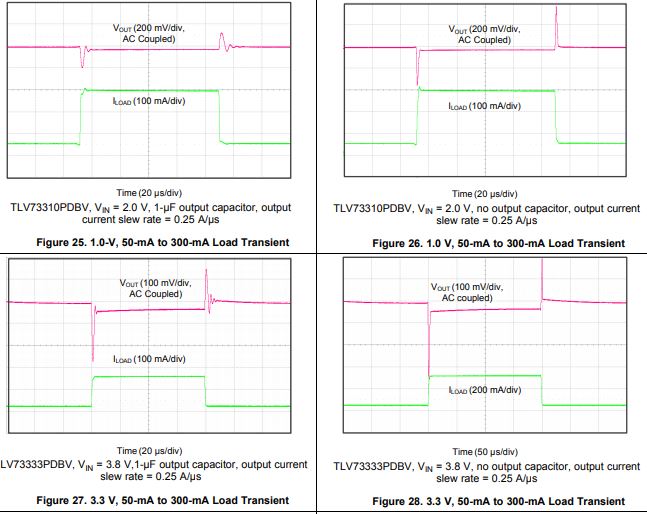

Why is cap free LDO stable without the output capacitor?
I understand that only the parasitic capacitance can compensate the internal control loop, is it correct?
Also, could you please provide any reference material on Cap free mechanism?
