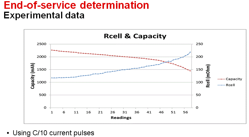

    Impedance Track devices do measure the battery impedance - actually they take several measurements during discharge to build an impedance table since battery impedance is a function of the DOD (depth of discharge). Impedance measurements are taken as part of the algorithm to calculate very accurate SOC (state of charge) and time to empty.
    I assume you want to know the health of the battery due to aging? I have not seen users use the Ra measurements in this way, but it might be possible. You should know that there are multiple conditions that must be satisfied to update the Ra table and your application would need to satisfy these conditions: For example, the device must see good relax periods to get accurate voltage readings, the SOC of the battery needs to see around a 40% change in state of charge to get enough resolution in the Qmax and resistance calculations. If this is a rarely discharged application (like UPS backup battery), this would not be a good device to measure resistance of the battery. The bq34110 hase an End-of-Service feature that would be more suitable for this type of application. See this video below to learn about this feature:
    www.youtube.com/watch
    Matt

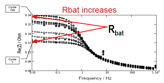

  • Yes, that is possible with the bq34110. However, it is important to keep in mind that the resistance measurements from the bq34110 should be used in a relative way (observe the resistance relative to the initial cell resistance to determine when the battery is ready to be replaced). The resistance measurement by the device will not match the battery manufacturer datasheet resistance because the measurement is at a different point on the frequency spectrum (DC vs. 1 kHz for most manufacturer datasheets).
    The video explains how the feature works in more detail. www.youtube.com/watch

    3. Using the EOS functionality, is it possible to obtain the impedance/ resistance value of the connected cells?
      • Yes, but as I mentioned before these are good relative measurements that will show the change of cell resistance over time. Battery cell impedance is usually specified by the battery manufacturer as resistance at 1kHz. Our devices measure the resistance at DC because that is where the resistance matters most for gauging and for determining the age of the cell.

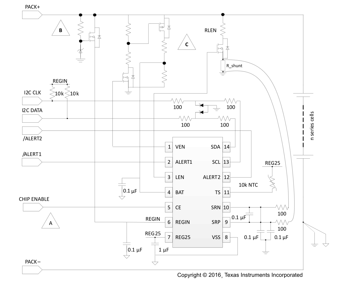

    This cleared thing up. This will be a tough one... I gues a shunt resistor on the RLEN will not do for the internal impedance track algorithm?
  • Yes, I agree there are some challenges with this very high current. I'm looking forward to see how you decide to do the current sense.

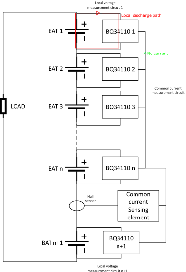

  • Hello Matt,
    I have been thinking about this application a bit further. Since as you said, the SoC mechanism is not needed for the EoS mechanism, thus, they can work separately, but the Current() function is still needed, I have came up with the following idea:
    Do you think such changed circuit would work correctly for EoS only? I have removed the shunt resistor from the cells series connection completely, and added it to the discharge load circuit. This way the current will be possible to be measured during controlled discharge. Of course I understand the drawbacks, but just for now, lets assume that during that discharge there will be no other discharge patches available. Would this work as a workaround? Or is the Current() function needed during charging as well?
    Otherwise, I am out of ideas. In this application there will be multiple 12 V batteries connected in series (total voltage of around 400 V) with a common charger for all of the series batteries. Each battery would have one BQ34110 controller attached. Measuring the total current of around 500 A through a shunt resistor (or other sensor) is not really an option here, it will be too expensive..
    I would appreciate your further help.
  • Hi Lukasz,
    This is an interesting idea. I talked with our system engineer about this and he thinks this can work if it can be guaranteed that no "normal" discharge current will start flowing from the load while doing the learning phase. Normally we monitor the current during the learning phase to make sure it stays near the intended level and will abort if current outside of that range is detected.
    The Current() function is used during charging. If you are relying on the bq34110 to indicate full charge completion, this could be important. If not, you will need another way to detect when charging should terminate.
    Matt

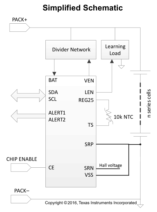

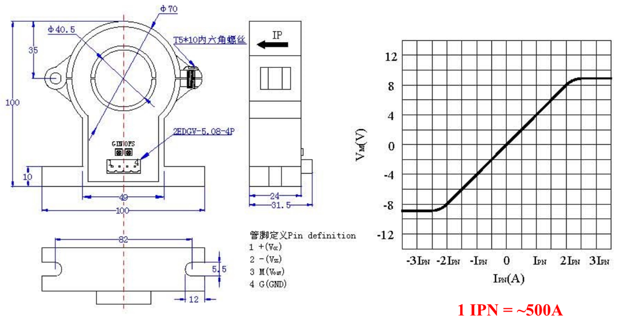

  • Hello Matt,

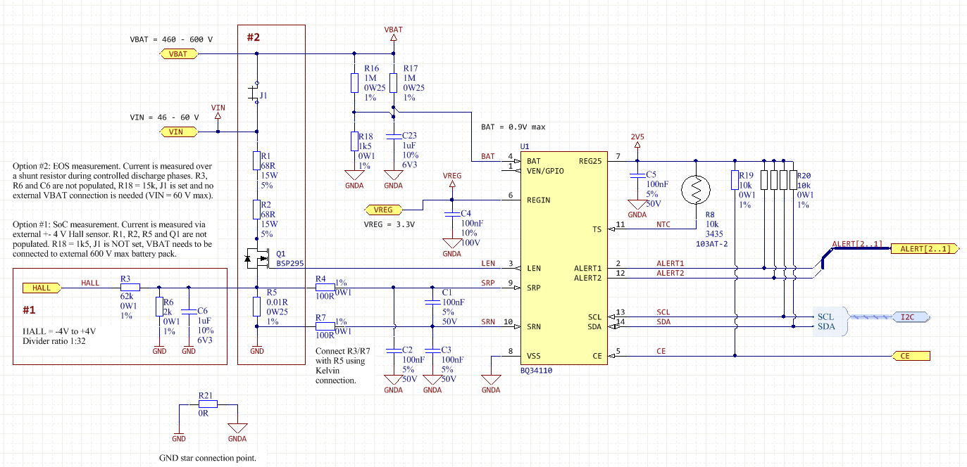

    I have some new information regarding the design. The hack with the shunt resistor in the load circuit might not be necessary after all, since there is a Hall current sensor available for the whole series pack:
    For this application, the sensor would output around 4V when 500A current was detected and -4V for -500A accordingly. Like you mentioned, the input range for the BQ device is +-125mV. In that case a voltage divider would have to be added in order to divide the voltage by 32 (4 / 32 = 0.125). I would then connect the hall sensor output through voltage divider to the SRP pin and ground the SRN pin. Is this approach correct?
    Assuming 14 bit ADC in the BQ34110 device, this should allow to measure current with around 30.05 mA (or 60.1 mA?). Is this enough for the SoC and EOS algorithms? Would appreciate your feedback.
  • Lukasz,
    I do not have experience using a hall sensor with the gauge, but this should work if the voltage across the ADC inputs is correct. I think you would want SRP to connect to VSS and SRN to connect to the voltage input. See this thread (another user was also looking at implementing a hall sensor): e2e.ti.com/.../730105
    The accuracy should be okay for the SoC and EOS algorithms.
    Matt
  • Hi Matt, thank you for answer.
    I find it a bit confusing about the SRP and SRN connection, since normally the local BQ34110 GND i tied to SRN pin. Is this circuit correct then? Am I missing something?
  • Hi Lukasz,
    Actually, on this device you should be able to connect the hall sensor output to SRP. There is a restriction on the BQ76930 (the other thread for the hall sensor was using this device) and that device expects to connect SRP to VSS. I checked and the BQ34110 does not have this same restriction.
    The BQ34110 can connect VSS to SRP or SRN. There are tradeoffs to both approaches which are discussed at around the 7 minute mark of this video: training.ti.com/bq34110-and-bq34210-q1-battery-gas-gauges-rarely-discharged-applications
    Matt

  • Hi Lukasz,
    This is a challenging configuration. I think it might be best to separate out the SoC and EOS functions. You can use one BQ34110 to monitor the entire stack voltage and the hall sensor and report the SoC. Then you can have one BQ34110 connected to each battery pack, but these cannot monitor SOC because the SRP/SRN pins will need to be connected across a sense resistor to monitor the learning load. You would need to control when the learning phase starts to ensure that the normal discharge/charge currents are not flowing through the system load.
    I think connecting the hall sensor output to multiple BQ34110 devices across the board would introduce voltage offsets that would be difficult to deal with.
    Matt
  • Hi Matt, Thank you for answer.
    Regarding the common voltage to current signal from hall sensor to multiple Bq- I think that adding a voltage follower with a low output impedance would solve this problem, but I agree that this is still a bit risky. The solution  proposed is a lot "cleaner". In that case however, there will be no SoC of individual packs, but the question is is that really necessary? Also going down from over 400V to around 4V for the Bq regin seems more problematic, but doable. Could also power the device from a single pack (just for the same of regin, not the whole system voltage). What do you think?
  • Lukasz,
    I think that's a good idea for REGIN since this just needs to be in the correct range to power the LDO.
  • Hello
    So I have some early version of the BQ34110 circuit:
    I would like to know your opinion about it. I have tried to introduce all of the solutions we have discussed about. So, there would be 2 mounting options for this circuit:
    1. SoC measurement. EOS is not measured.
    2. EOS measurement. SoC is not measured.
    In the design there are 10 series packs. Each pack is 60V max, so the whole string is 600 V. Each module (pack) has an EOS measuring BQ34110 and for the whole string there is 1 SoC measuring BQ34110.
    I would appreciate your thoughts on this solution.
  • Hi Lukasz,
    This looks correct to me based on the unique application needs we have discussed.
    Matt
