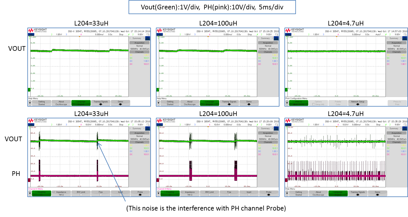

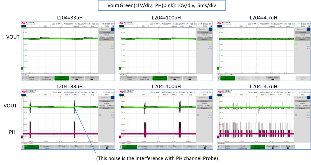

[Comparison of different inductance value (when no load attached)]

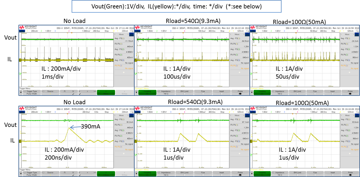

[Comparison of different Loads with inductance=4.7uH (above circuit diagram)]
