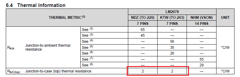

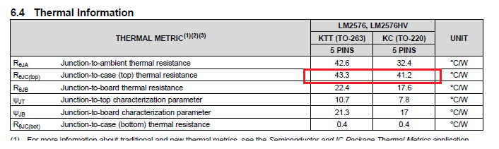

Hi Arief,
In the LM2576 and LM2676 datasheet, customer found a lot of difference on the parameter of RθJC(top). Since both parts have similar function and I don't see any heat sink applied on LM2676 datasheet. Customer just wondering is it a typo?
LM2576
LM2676
Customer will do thermal calculation before evaluation, he don't want to calculate out wrong data. (there is a typo on this chart, LM2678)
Best Regard,
Vincent
