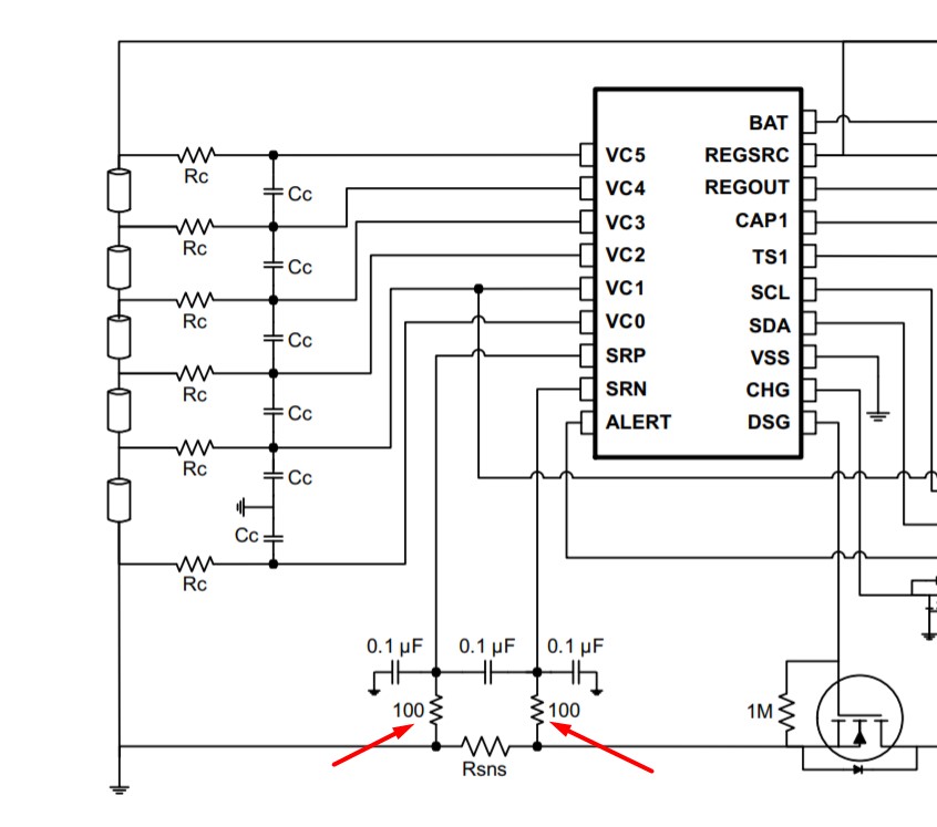

BQ76930: Why is there series resistors and capacitors for Rsns for current sensing?
Part Number: BQ76930
Are the resistors(red arrow) and capacitors in the circuitry for Rsns current sensing circuitry for low pass filtering ? Should they be matched or changed for varying Rsns values ?
Are they 100ohm and 0.1uF values accounting for the coulomb counting measurement updates ?

  • Hi Eohan,
    The external filter is used to average the current across the sense resistor during the sample period (sampling occurs every 4 us). The values do not need to change for different Rsns values.
