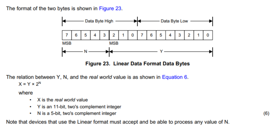

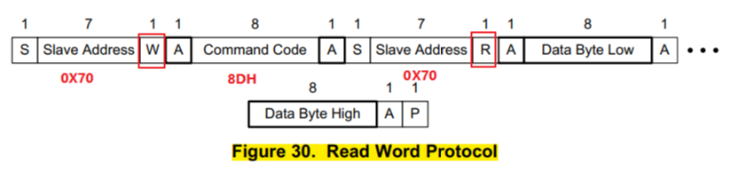

How to mearsoure the temp?I has the mistake blow
    Can you please tell me more about the issue you're having? It's not quite clear from your post.
    Are you getting the wrong temperature value through the PMBus versus what you're measuring with an IR probe? Or, are you having trouble getting a proper PMBus transaction?
    If it's an incorrect temperature I'd be happy to check the schematic and layout to see if there are any issues. Otherwise it could be a PMBus issue in which case I can check the schematic still but there might be something else at play unrelated to our part.
