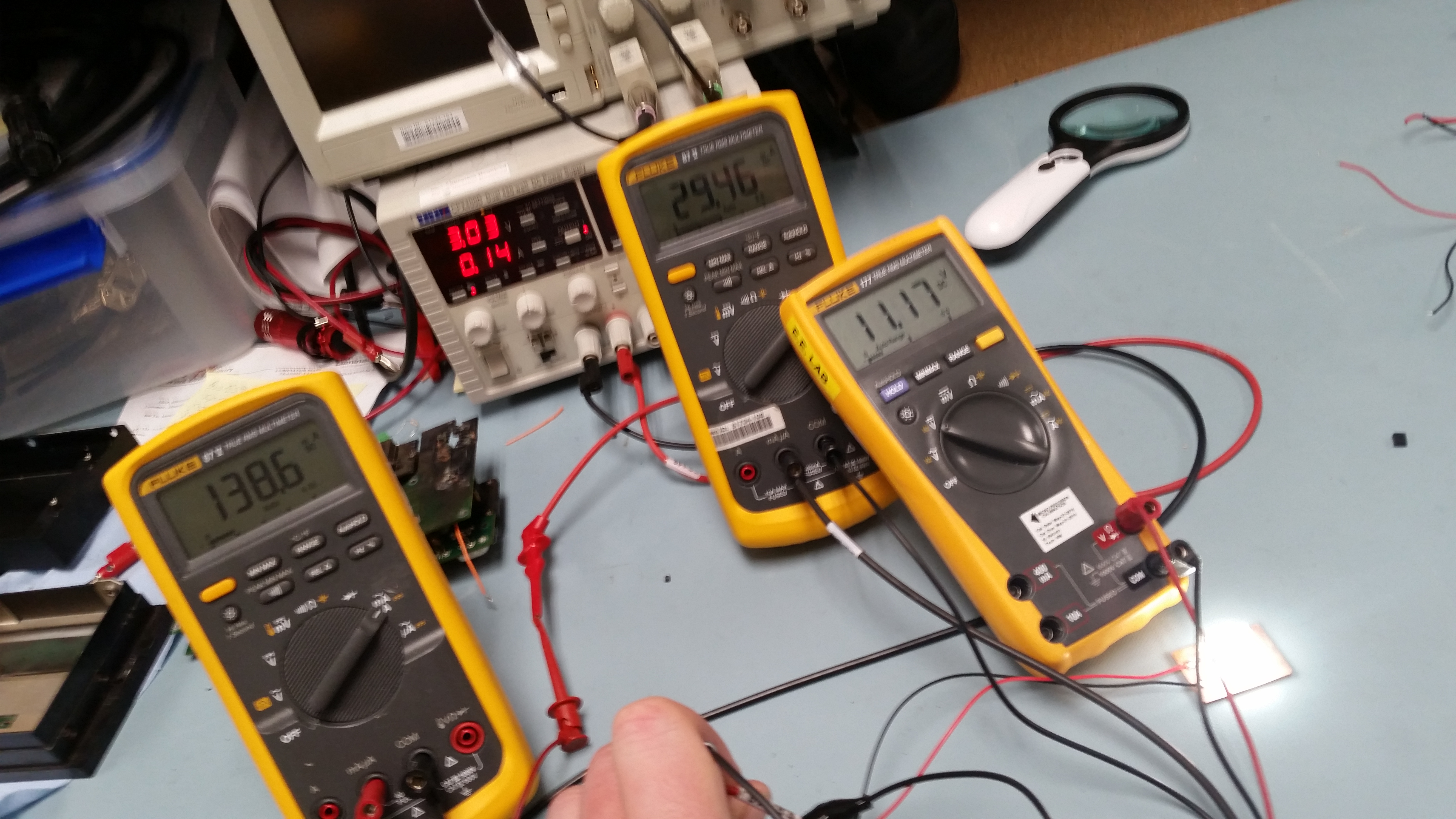

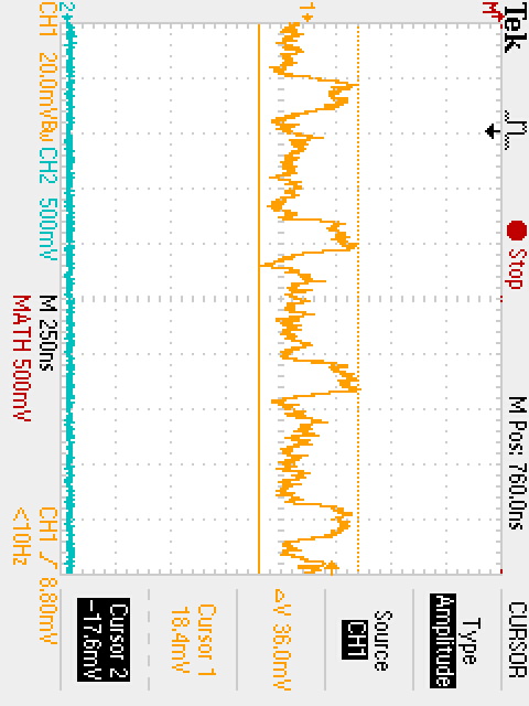

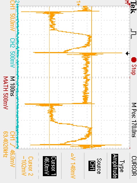

    I did have another question.  Attached I have waveforms from my o-scope of the input voltage and output voltage as well as a picture showing the efficiency (~78%).  Would increasing the capacitance on the input and / or output make the efficiency any better?  I'm not complaining about the 78% as that is pretty good, but I was wondering if I could make it better.  All I modified on the board was changing R1 to 6.49 ohms (30ish mA), adding a 100k pull-up to DIM, and adding a 0 ohm to be able to use the DIM if I wanted (not used currently in my design).  Input ripple is 36 mV.  Output ripple is 148 mV.

    Increasing the input and output capacitors probably won't make much difference efficiency wise. You can try doubling them as see. It just depends on how much is being lost in the resistive portions of the circuit (RMS losses). Average losses such as diodes won't really change much. To find out what would improve efficiency would require going through the entire design to see where the losses are. Most will probably be in the power components, switching loss, inductor losses, etc.
    Glad it's working for you.
