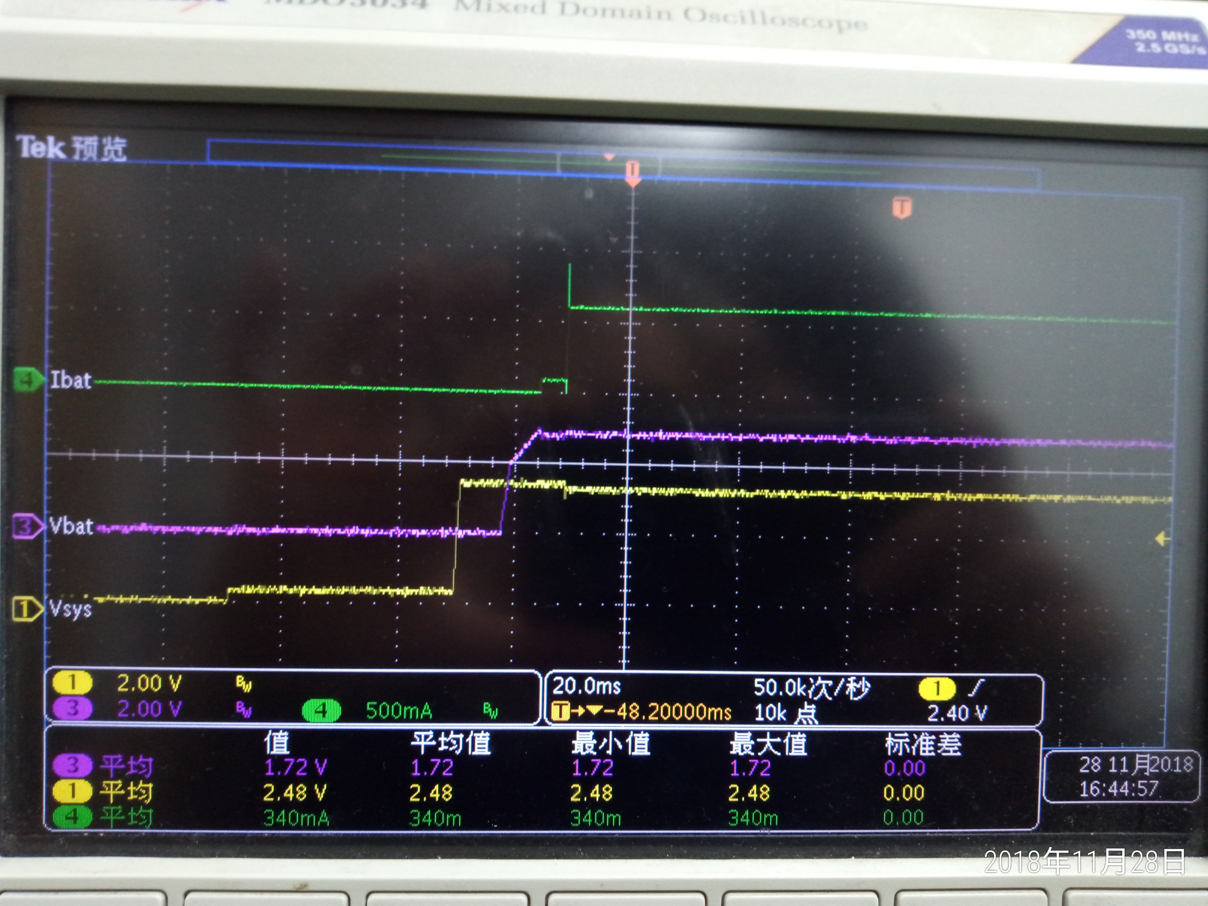

I am debuging a BQ25601 strange status. My customer battery protect VLO is 2.8V, and release voltage is 3.0V
hen battery is in protect status, and then plug in adapter ( PSEL = HIGH ), we have a big chance see the charge current to 500mA
But in that bat voltage, the charge current should be 180mA for precharge mode.( main control not work so reg is in default mode )
I also measure the power on voltage, BAT voltage seems not over 3V. So I have no idea why the charge current is 500mA.
Do you have and suggestion for me to check where would be the problem and how to debug.
