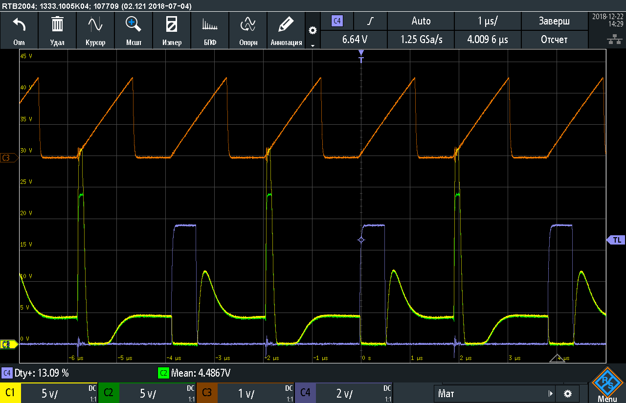

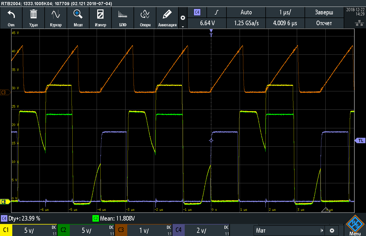

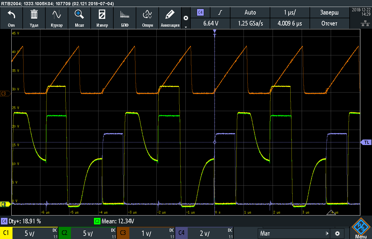

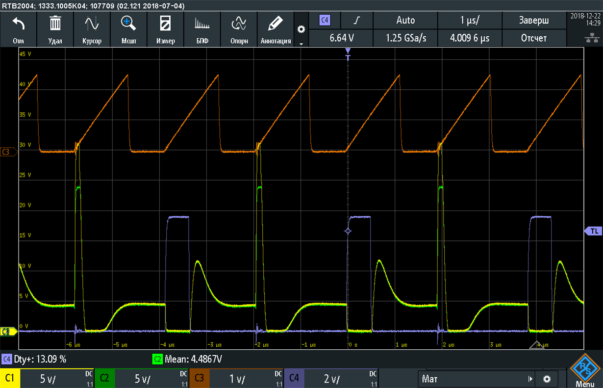

LM5035: LM5035:Unbalanced pwm
Part Number: LM5035
Orange - RAMP
yellow - HO
blue -  LO
COMP=360 uA
CS=0 (closed pin IC )
COMP=460 uA
COMP=560 uA
in all examples, the transformer windings are loaded on resistors without rectifiers and capacitors
when the feedback signal changes (from 560 to 360 μA back), PWM does not restore symmetry to some value of the feedback signal (hysteresis)

  • Hi Kitov,
    Since there is an internal current mirror on comp pin, small voltage change on comp pin may cause large voltage change on the negative node of PWM comparator and thus make duty cycle unbalance. I do not know how you injected current to comp pin but it is very likely that the noise from current injection caused the duty cycle unbalance issue.
    Frank
  • Hi Frank,
    1) the current at the COMP input is set by the YOKOGAWA CA 71 current source
    2) even if it is noise, why does it affect the upper channel steadily? At the same time, the lower channel is controlled predictably. PWM The unit in the chip is common, and the behavior should be symmetrical for both channels. The noise really is and it manifests itself in the form of jitter on both channels.
  • Hi Kitov,
    I have calculated the expected RAMP voltage at the falling edge of PWM with the injected current you provided for each case. When the current injected to comp pin are 360uA and 460uA, they are equal to 2.2V and 1.7v seperately which are roughly consistent with your provided waveform. When the injected current is 560uA, the calculated RAMP votlage at the falling edge of PWM is 1.2V. It is still equal to the captured votlage at the falling edge of low side MOS, but is inconsistent with that at the falling edge of high side MOS. So I suspect there is noise coupled onto either RAMP voltage or the current souce injected into COMP pin when high side MOS is turned on. Since you did not provide the current source waveform, which may be difficulted to be measured, I can only look into the detail of RAMP votlage waveform and found that there is obvious noise coupled on it. Even though the magnititude of the noise are still below 1.2V and cannot make PWM comparator toggle, it is a clear indicator that there is a noise happened at that moment and very likely coupled onto the current source into comp. If you look into the RAMP votlage when low side MOS turns on, there is no such kind of noise. Therefore, it explains the steady unsymmetrical waveform.
  • Hi Frank,
    Indeed the source of the problem was noise. Two oscilloscope probes were connected to the product. The probe that was connected to the CW had poor contact with the ground. Thus, when the upper transistor was turned on, the high frequency current did not return to the desired point, but passed unpredictably on the board through other connections and distorted the feedback behavior.
    Thanks for the support!
