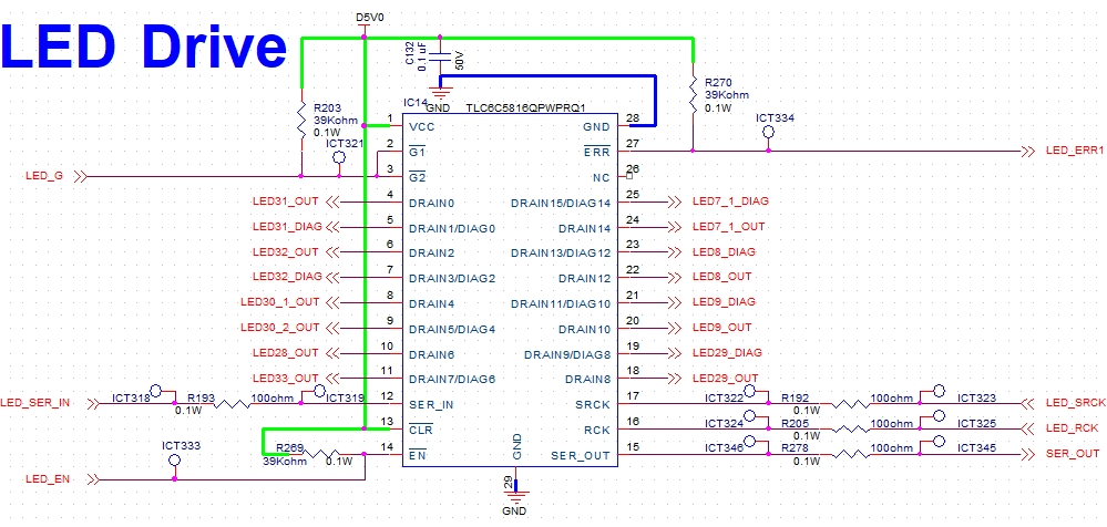

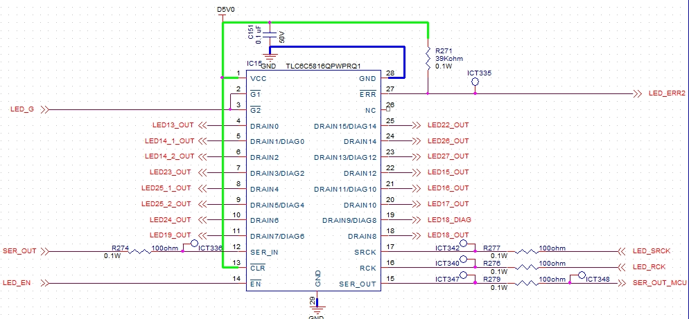

I want to use standby mode of TLC6C5816-Q1
When SRCK, RCK, SER_IN, SER_OUT are setted to input Hi-Z, EN output high Level. Iq of TLC6C5816-Q1 is about 600uA, can't enter standby mode.
How should I set MCU Pin type? Thanks!
Sch as below.

What kind of system are you using this device in? Do you have Iq requirement for it?
Pull EN pin high will make the TLC6C5816-Q1 enter standby mode, the Iq for each device will be 1uA only.
