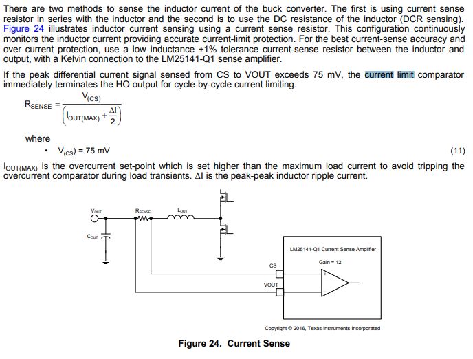

our client use LM25141-Q1, but we study datasheet and find RES pin look like enable hiccup mode, we test if output current overcurrent will enable hiccup mode( current limit threshold) SW was stop and output voltage was drop.
if we Pull up RES pin to VDDA, will shout down hiccup mode and output voltage was work.
General design LM25141-q1 use RES pin always pull down to GND?
