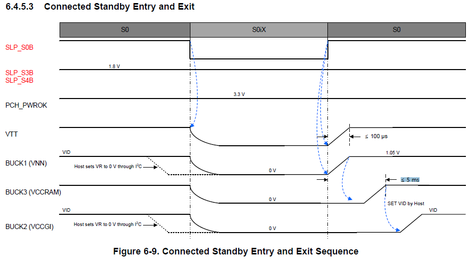

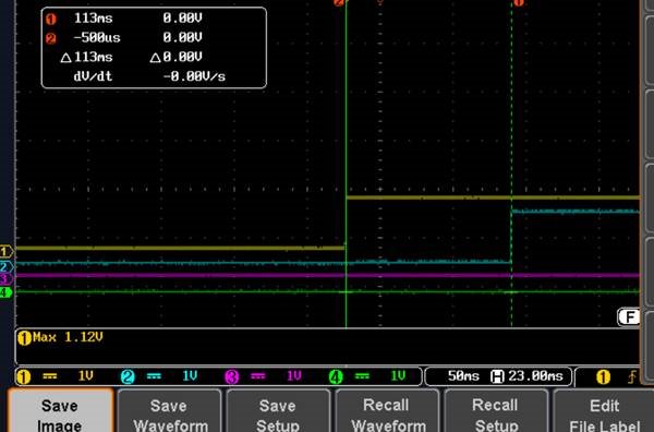

oul client measurment Buck1 and Buck3 Sequence is greater than 113ms, but we find the datasheet 6.4.5.3 Connected Standby Entry and Exit as below show greater than 5ms.
measurment buck1 and Buck3 Sequence is greater than 113ms
