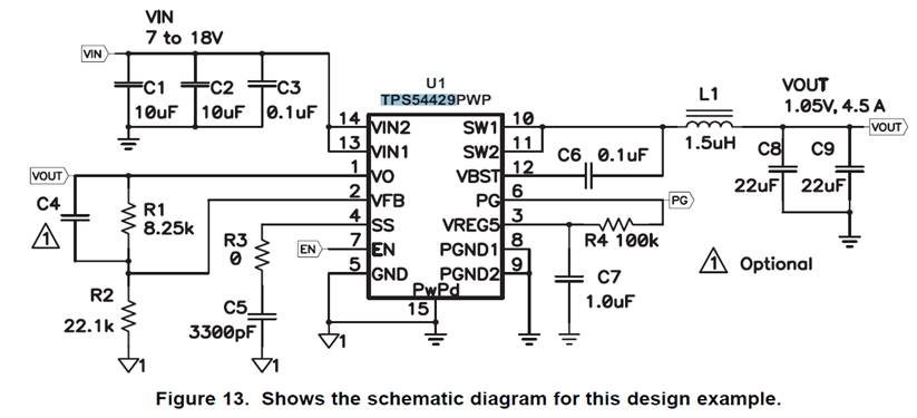

I want to set the capacitance of the output capacitor of TPS54429 to 100 μF.
Is it possible if special measures are taken?
(We would like to set C8 + C9 = 100uF 1 piece.)

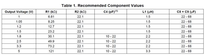

Even the recommendation range is from 22 to 68uF.
