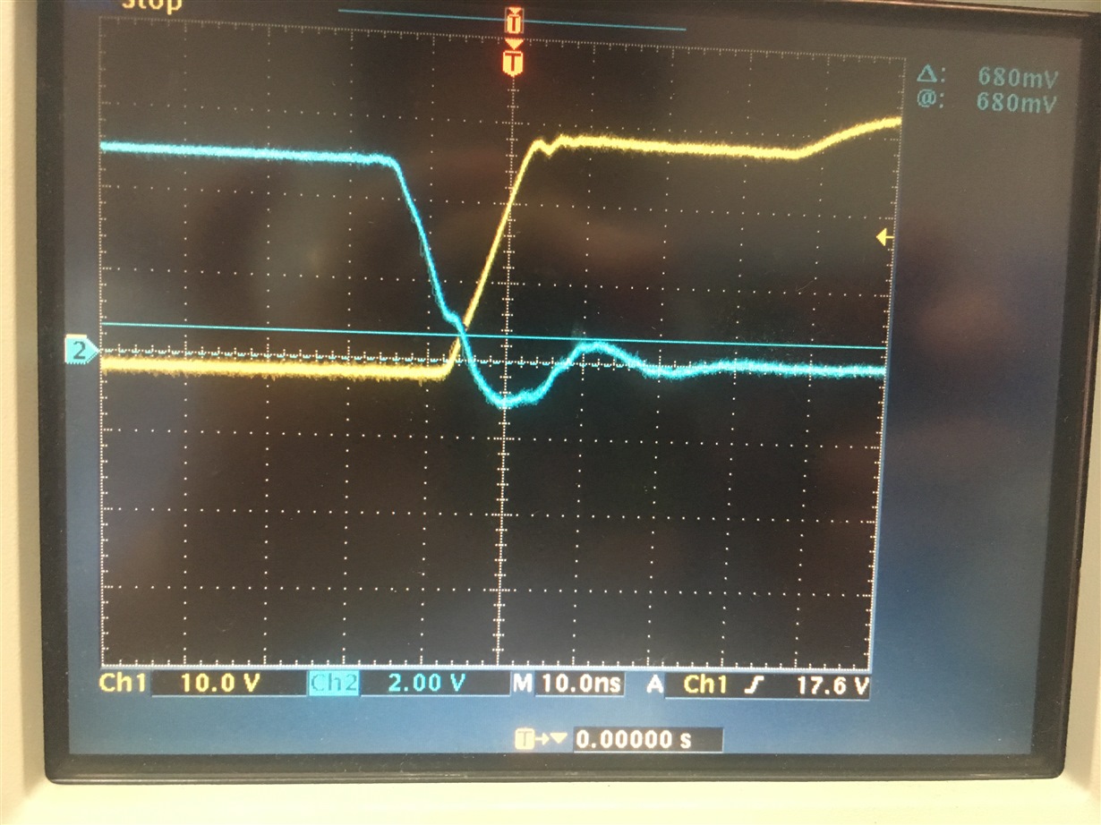

Hi Tommy,
From the waveform, seems SW OS can't bigger enough to damage L-MOS.
Do you check the Dead time whether is bigger enough? and When the damage happen? if possible, could you please catch some waveform during the damage happen?

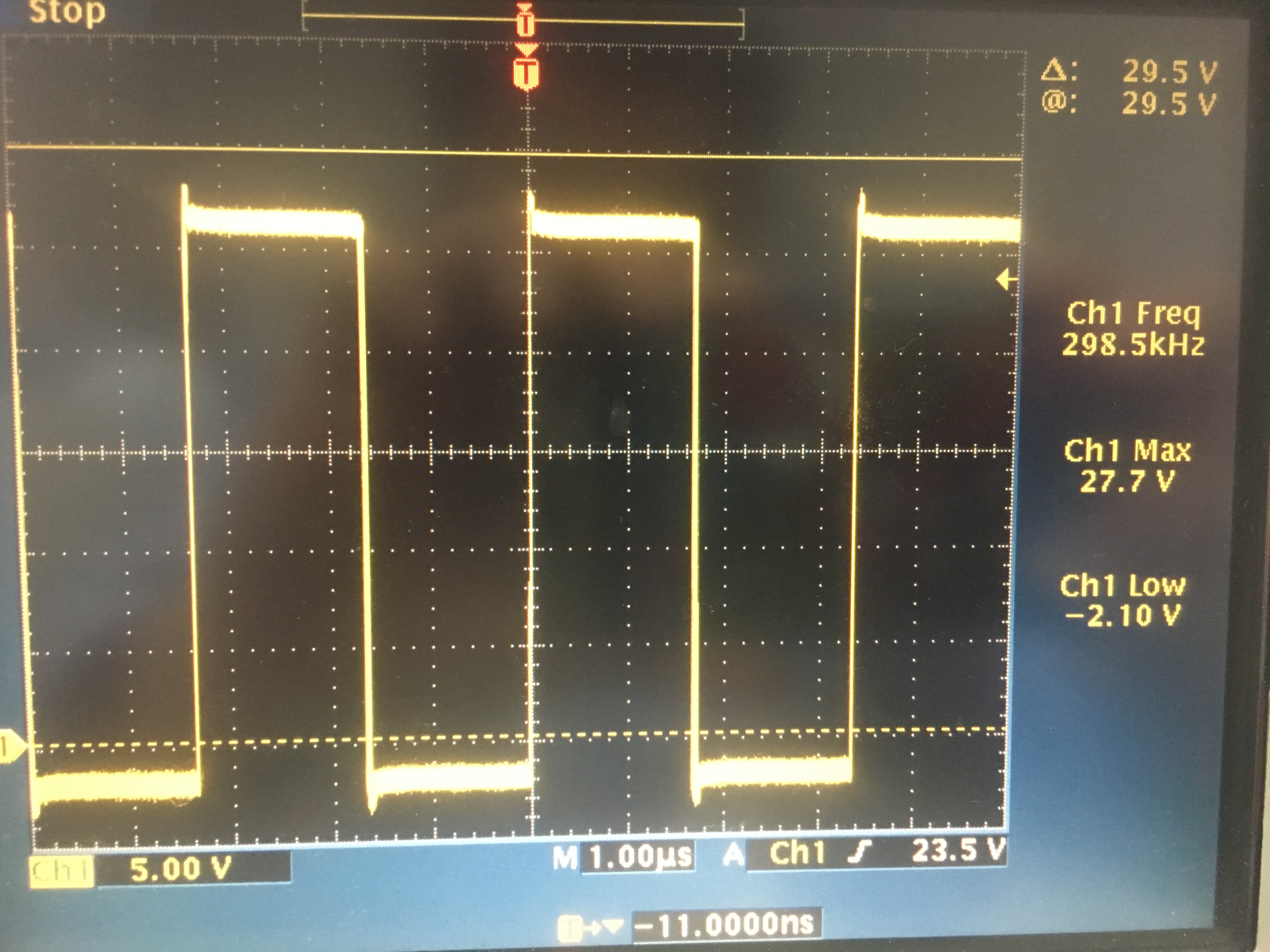

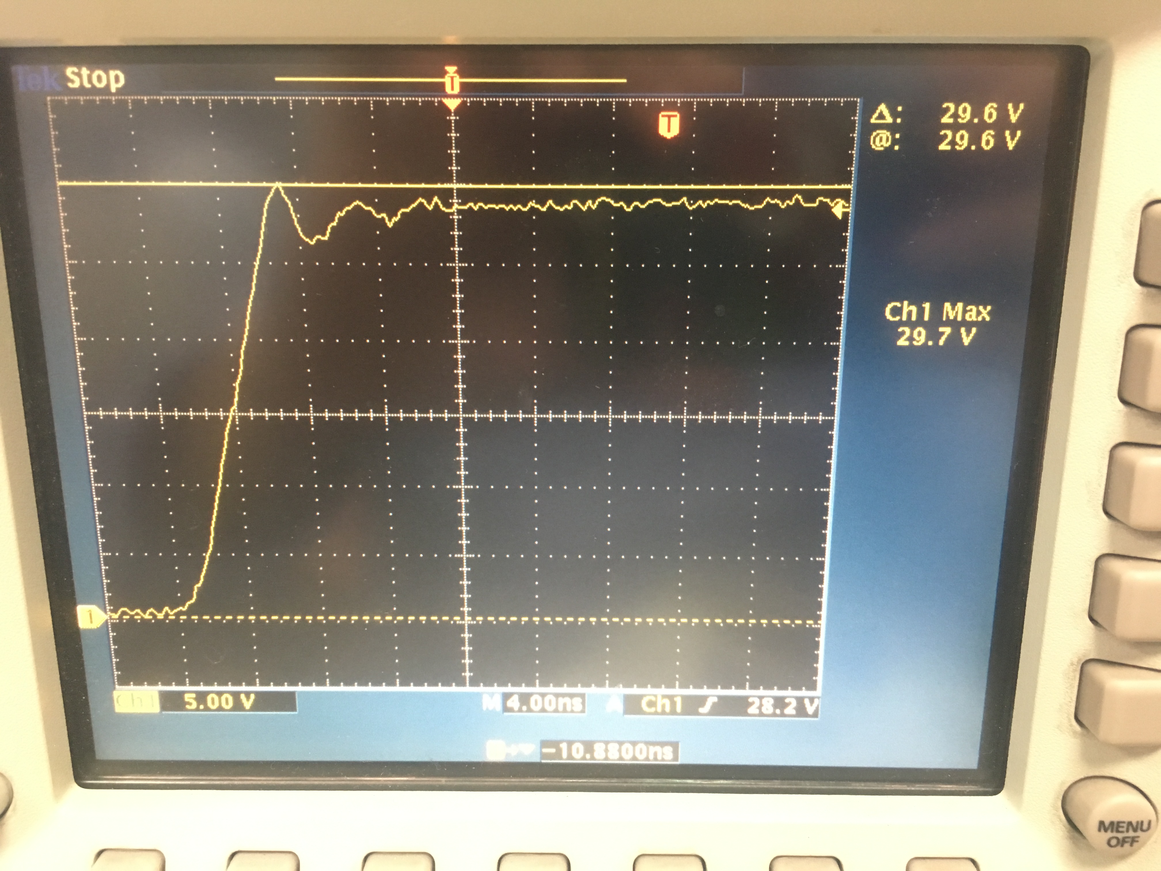

Hi Tommy,
Confused why the Vin looks higher than the value in the word " Phase pin....20190201" you uploaded before? this time the waveform are almost getting 30V VDS which is Mosfet spec.
And if we check dead time, we should check VGS of High-side not only Vgate.
