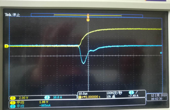

we use the BQ24610 for battery charger base product,
but we find there is a strange behavior on the charger IC, please help check the test waveform in the attached file.
and we also find the large current from battery to charger IC during the battery insertionBQ24610 design.pdfBQ24610 design.pdf
  •  when battery is not connected with the charger IC circuit, find there is voltage drops on VBAT, if at this time, the battery is insert, the battery voltage is higher than charger IC output voltage, the large current shall happen
  • Hey Tony,
    To me this looks like inrush current into the capacitors of the charge controller's output LC tank. Based on your description, it seems like the worst of the inrush current is during the low period of battery detection as described in section 9.3.23 Battery Detection of the datasheet. The low point is shown in Figure 17 when the battery voltage causes VFB to fall below the VLOWV threshold.
    This is considered normal behavior during any plug in event.

  • Hi Joel ,
       please check the below captured waveform(no prebias 3V added), we find that some time VBAT voltage is not so high.
  • Hi Joel ,
    when the adapter is not attached, the test waveform can be found as below, the inrush current is so high. is there any soution suggested for so large inrush current? tks a lot in advance!
    we also test the inrush current on your EVM board without power adatper attached, please check the below:
    BRS,
    TONY LIU
  • Hey Tony,
    VSRN (VBAT) collapsing is due to the battery detection circuitry. It pulled current from SRN to discharge the node and pushes current into the SRN to charge the node. If the node moves, the charger detects that there is no battery present. This is why you see the voltage dip.
    As far as the inrush current, again I will say this is due to the capacitors on the board. You have 30uF of output capacitance. The EVM has double the capacitance (including the 40uF of capacitance on the input rail that the battery will always see). So you see double the current.
    Joel H
