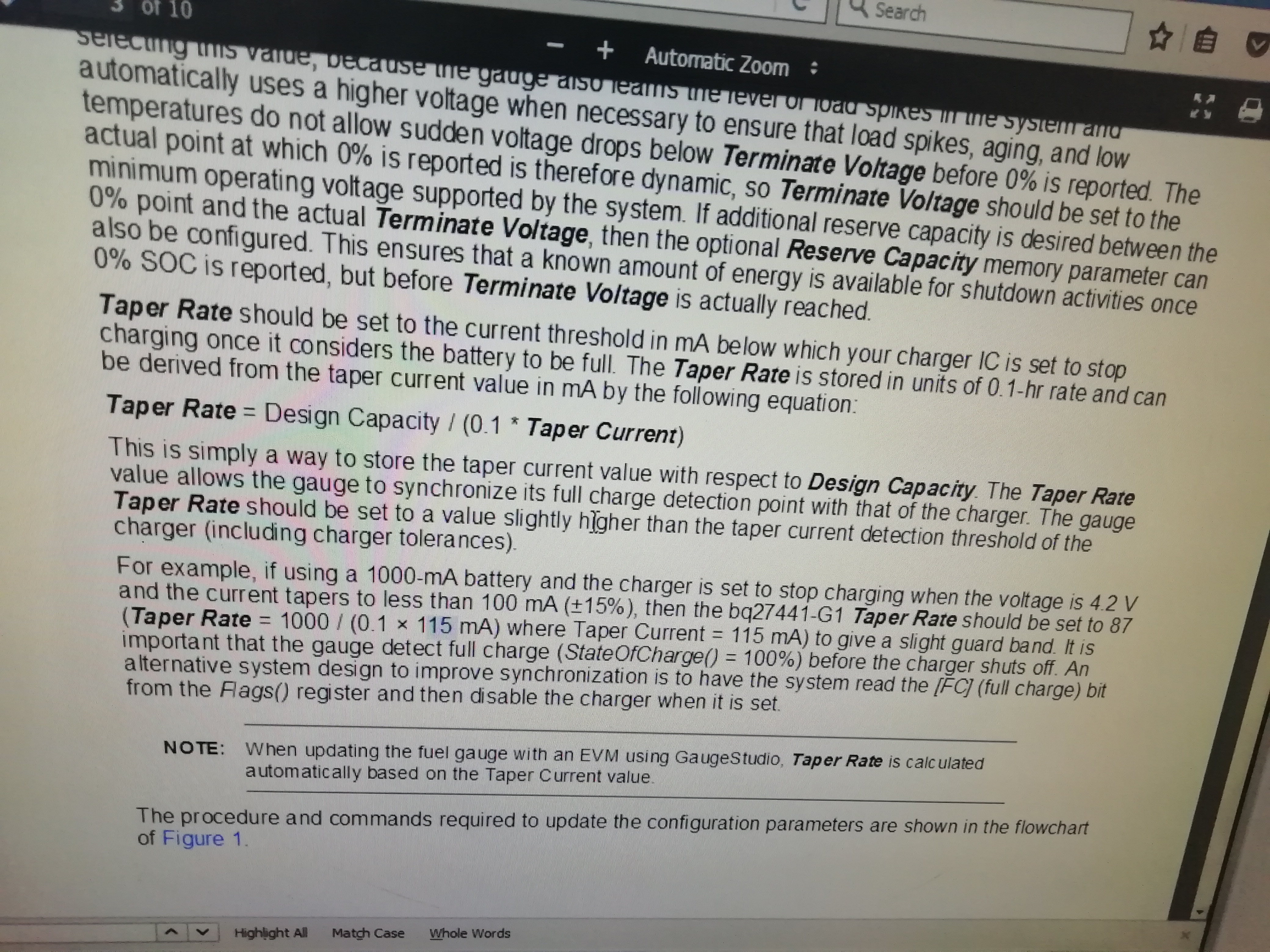

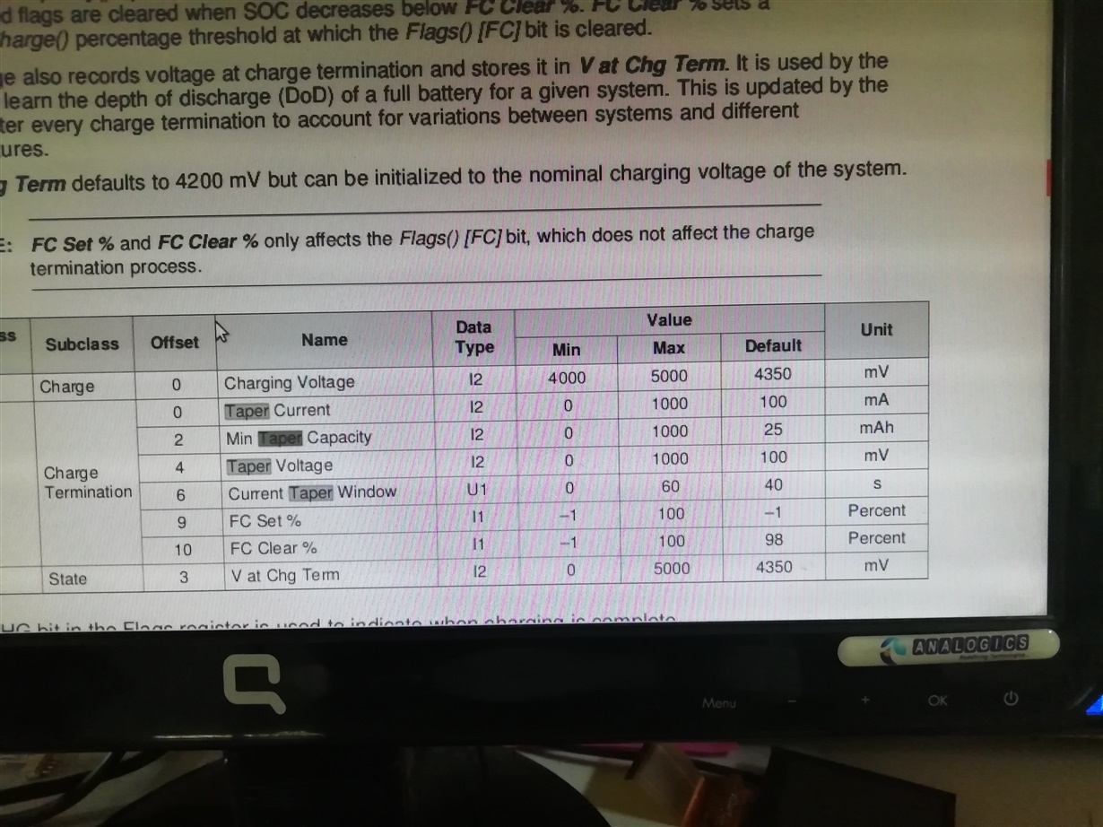

  •   hi i m using 3.7v 5200 mah battery and bq27542 fuel guage. in this taper current and taper voltage is 100 mv and 100 mah for 1000mah battery.  as we seen in the bq27411trm we used the formula for the taper voltage  we are getting for my battery is 520mah.but the default vales are 100 mah.can we use the 520mah for taper voltage for we should keep 100mah....??????please check the following attachments
  • Hi
    pls for next time start a new post and do not post a follow up to an already existing post from a differnt user. you could post a link reference the other post in your own post..
    For a 5200mAh battery, a good taper current should be bw c/10 and C/20. Quit current should be set to c/20 or less. Keep the taper voltage as the default value.
