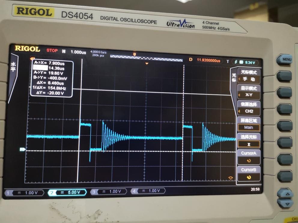

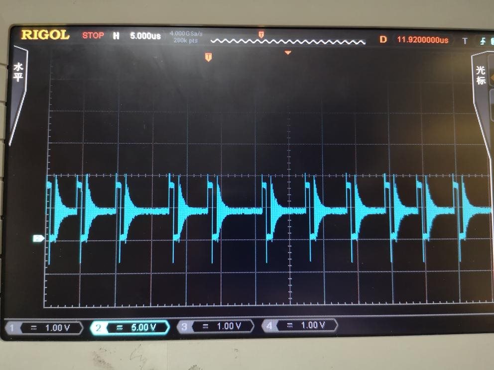

Background

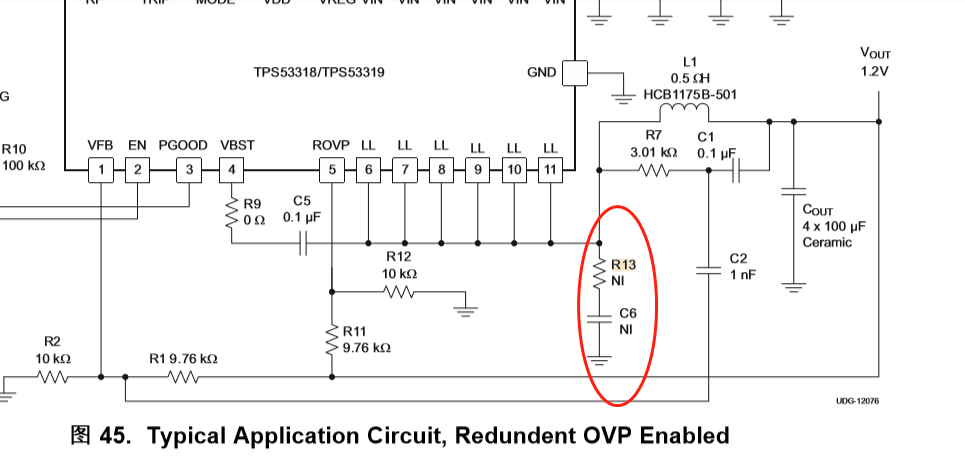

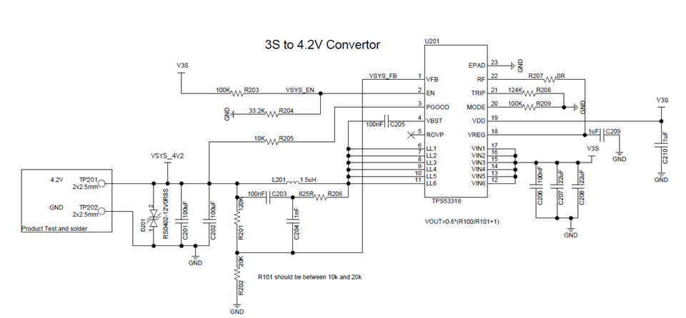

The TPS53318 in Customer’s Main-board, and the TPS53318 output a power supply (4.2V) to Main-borad.

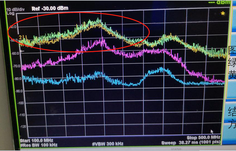

In the RE certification process of FCC/SRRC, at 100MHz-500MHz, some noise be detected in main-board, and so, the certification failed.
Debug

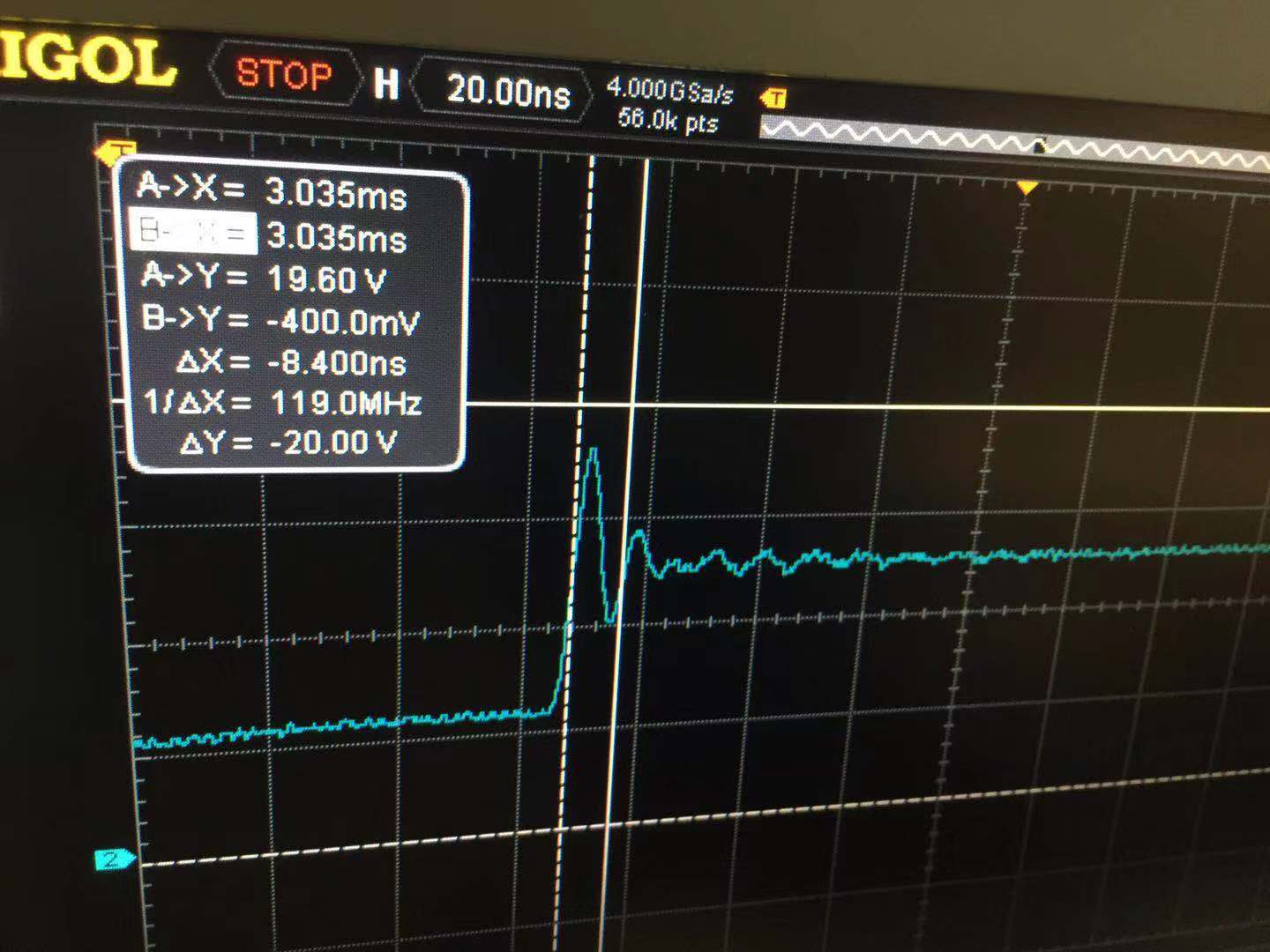

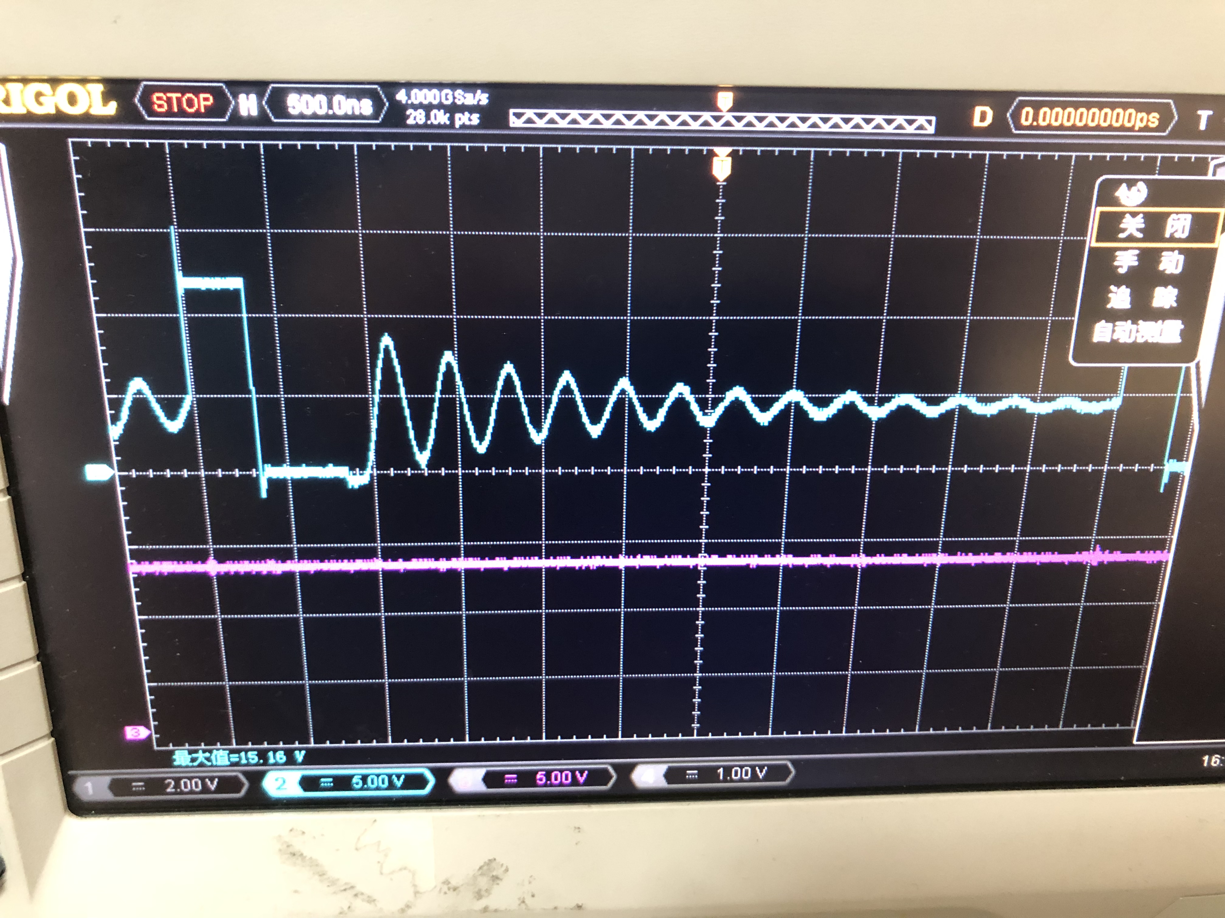

1, Noise can be detected in all the parts of main-board. And on the right above of TPS53318, The strongest noise be detected, the difference is about 20dB. So customer suspect TPS53318 is the source of noise.
2, Replace TPS53318 by DC-power directly, the noise disappeared.
3, the customer tested FCCM and Skip mode separately, The noise situation is the same.
Need help
1, Why does noise occur?
2, What can we do to make the noise go away?
