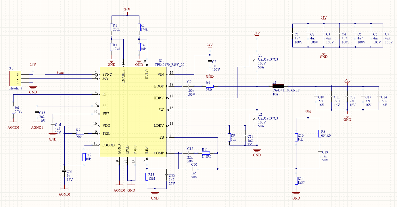

TPS40170: HDRV and LDRV of TPS40170 are no working
Part Number: TPS40170
I am designing a 5V and 4V output with 3A power suplly with the TPS40170. I have a protoytpe now where the VBP and VDD can be measured but i can´t switch the MOSFET, because not switching signal on LDRV and HDRV, what could be the problem? I measurde all the voltage and they are in the range.
